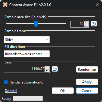

1. Don't trust the defaults. The tiniest change in the sample size can have a big effect on the outcome, as does the selection itself.
The first try I had with your image used a sample size of 15. Redoing the selection + 15 looked awful. I had better results with 67.
2. Don't remove the object first. Take our time and select around it with care. Then run the plugin directly on the selected lady.
Your object in the image is taller than it is wide, so I'd select the refill from the sides. This will take the refill pixels from more horizontal offsets than vertical.
I tend to use Inwards fill. It just seems to be better at object removal.
So, try something like these settings:
In saying that, I don't think you're going to get a seamless result out of the box. You're going to have to do some manual fixing.
