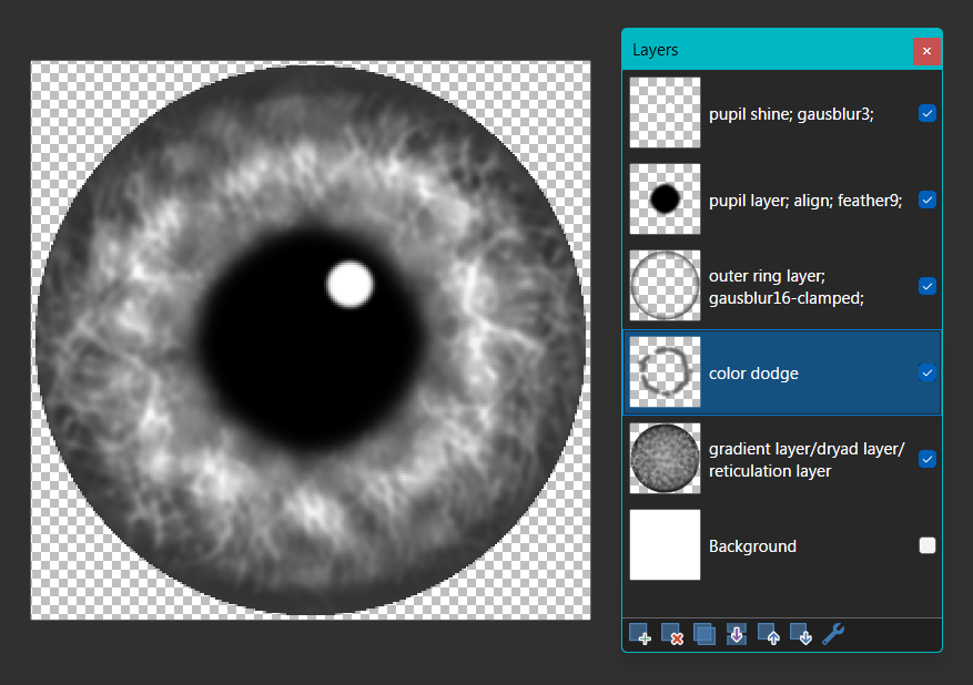

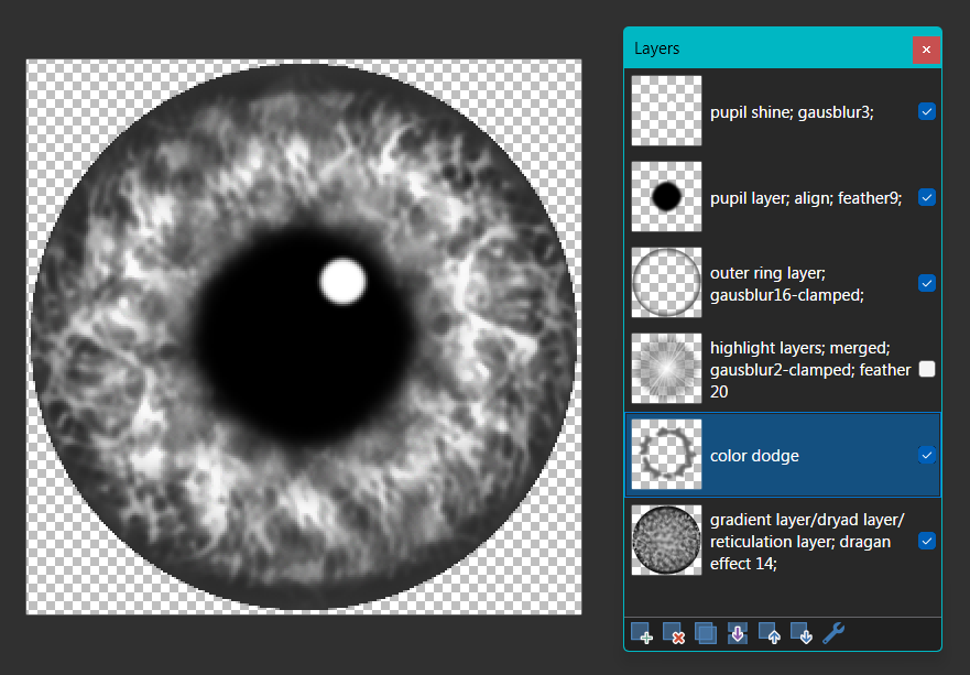

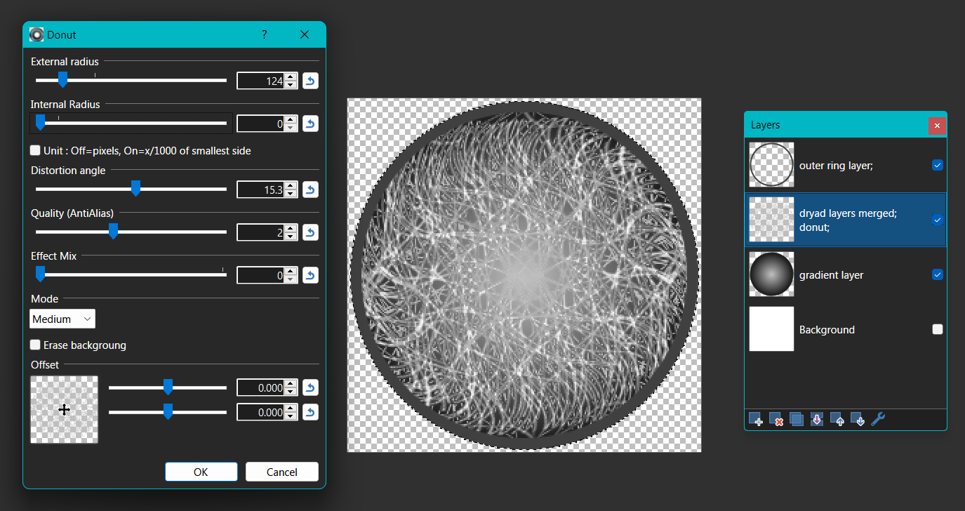

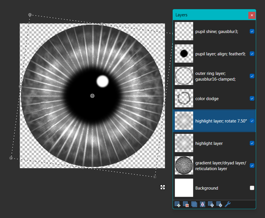

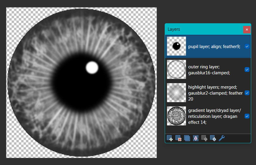

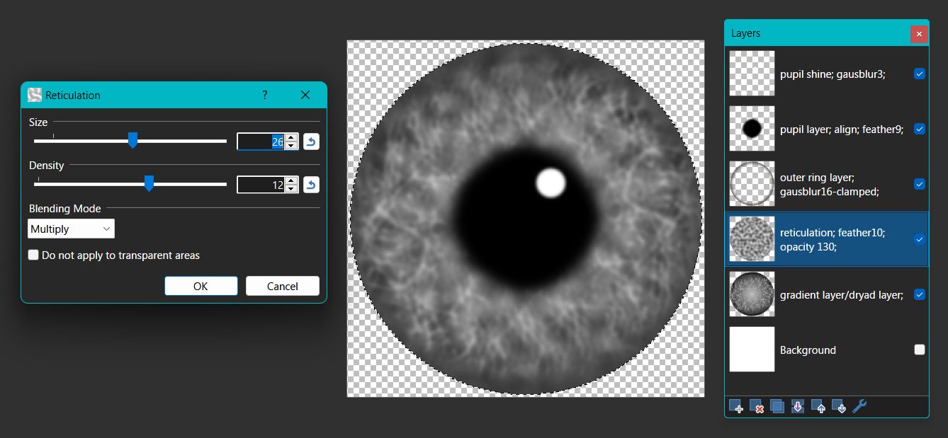

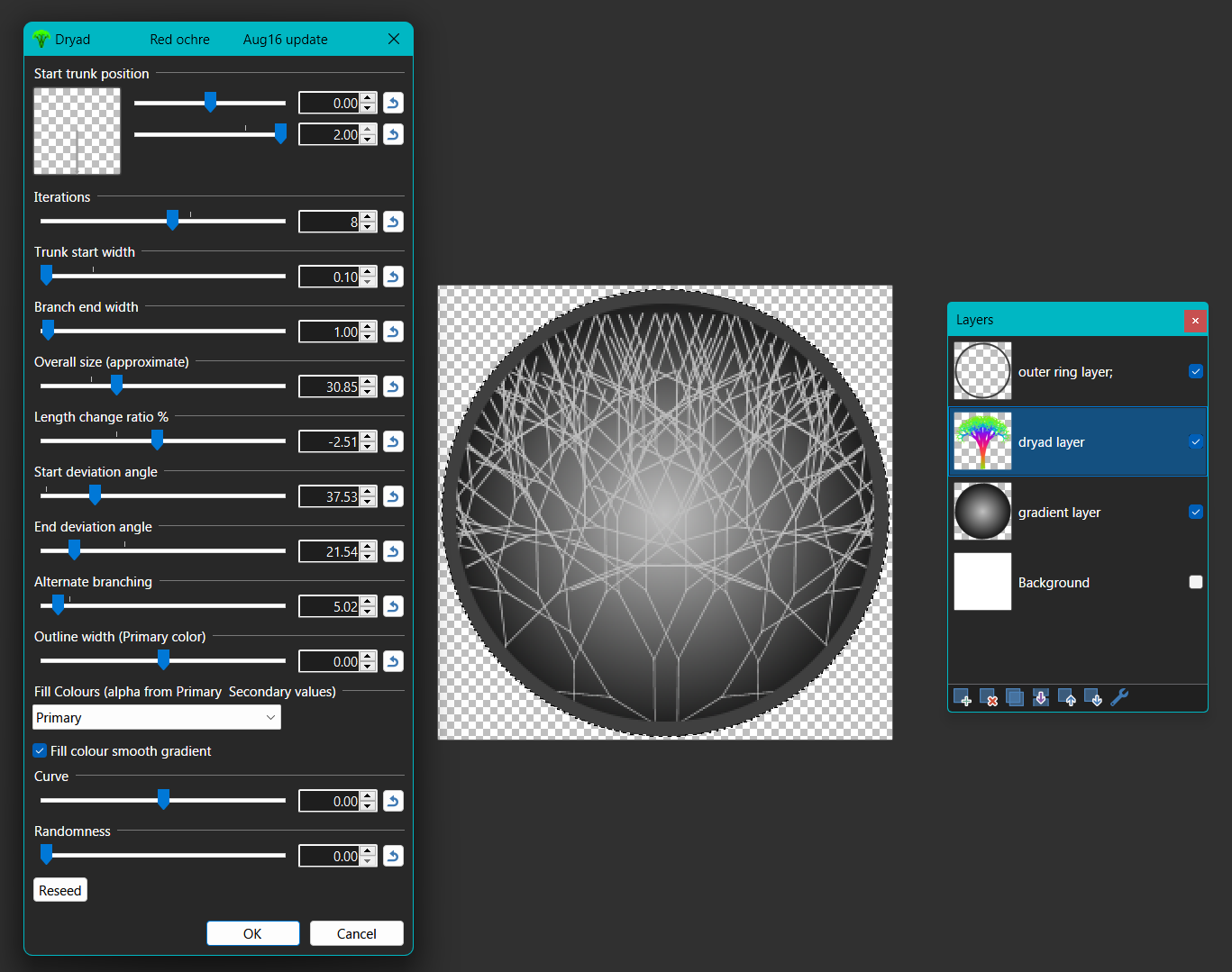

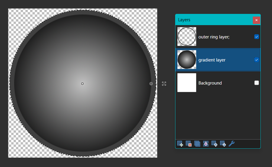

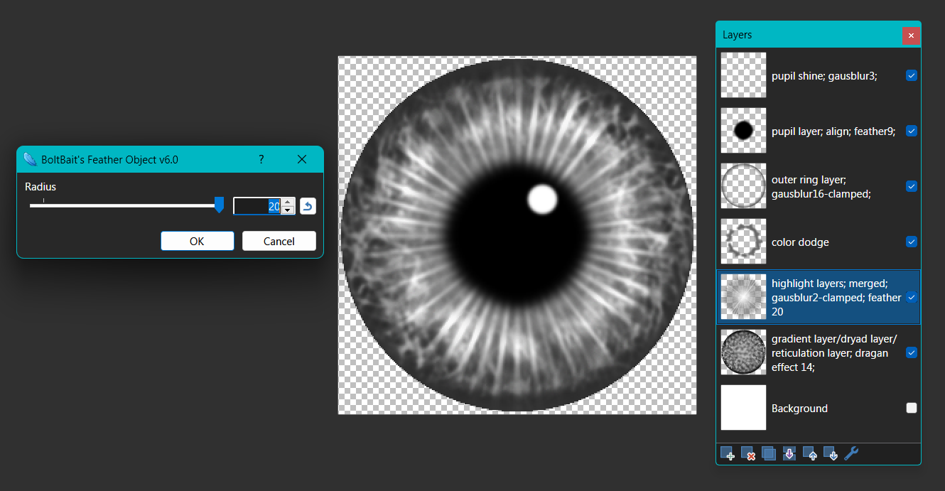

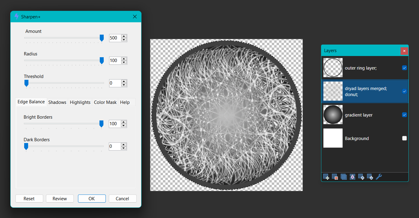

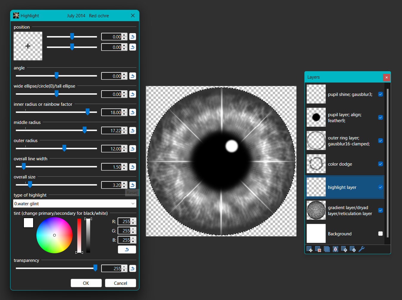

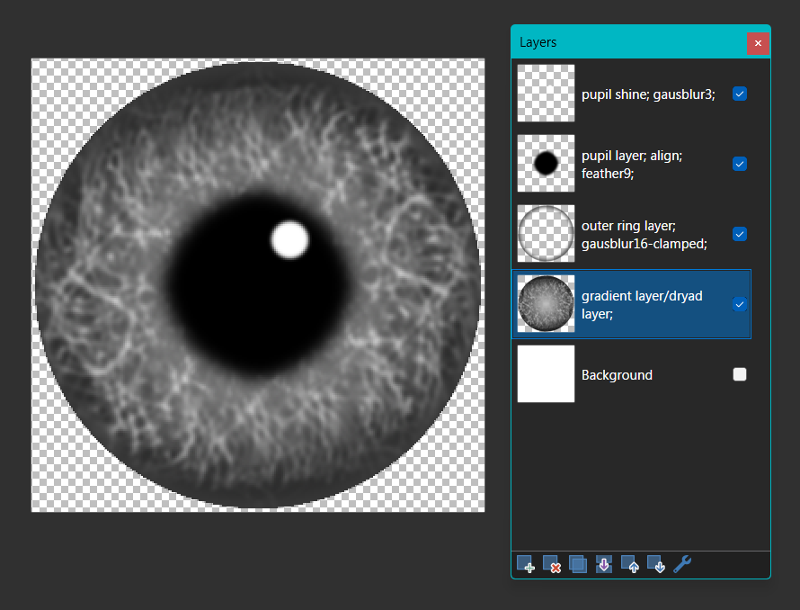

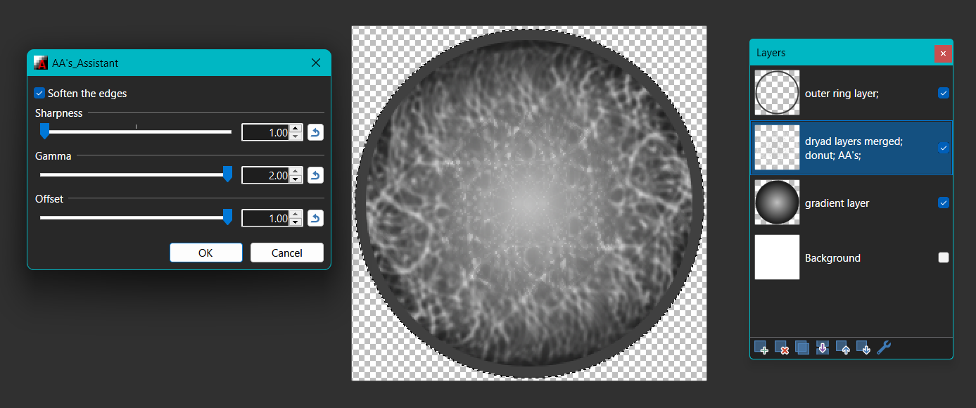

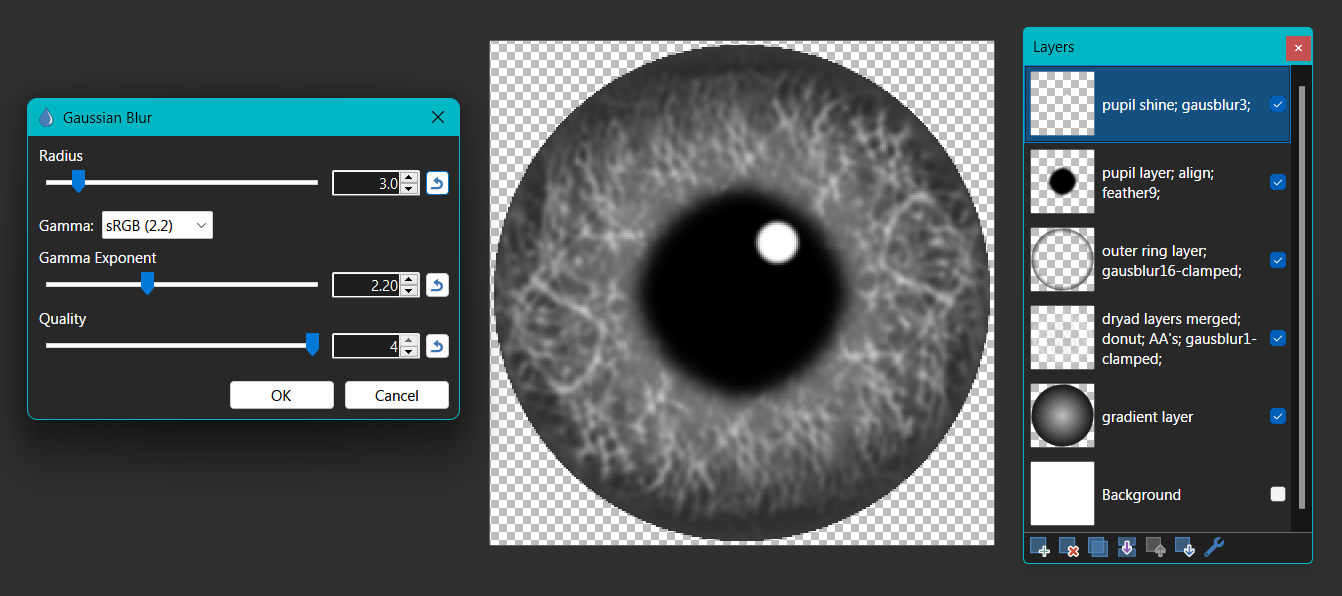

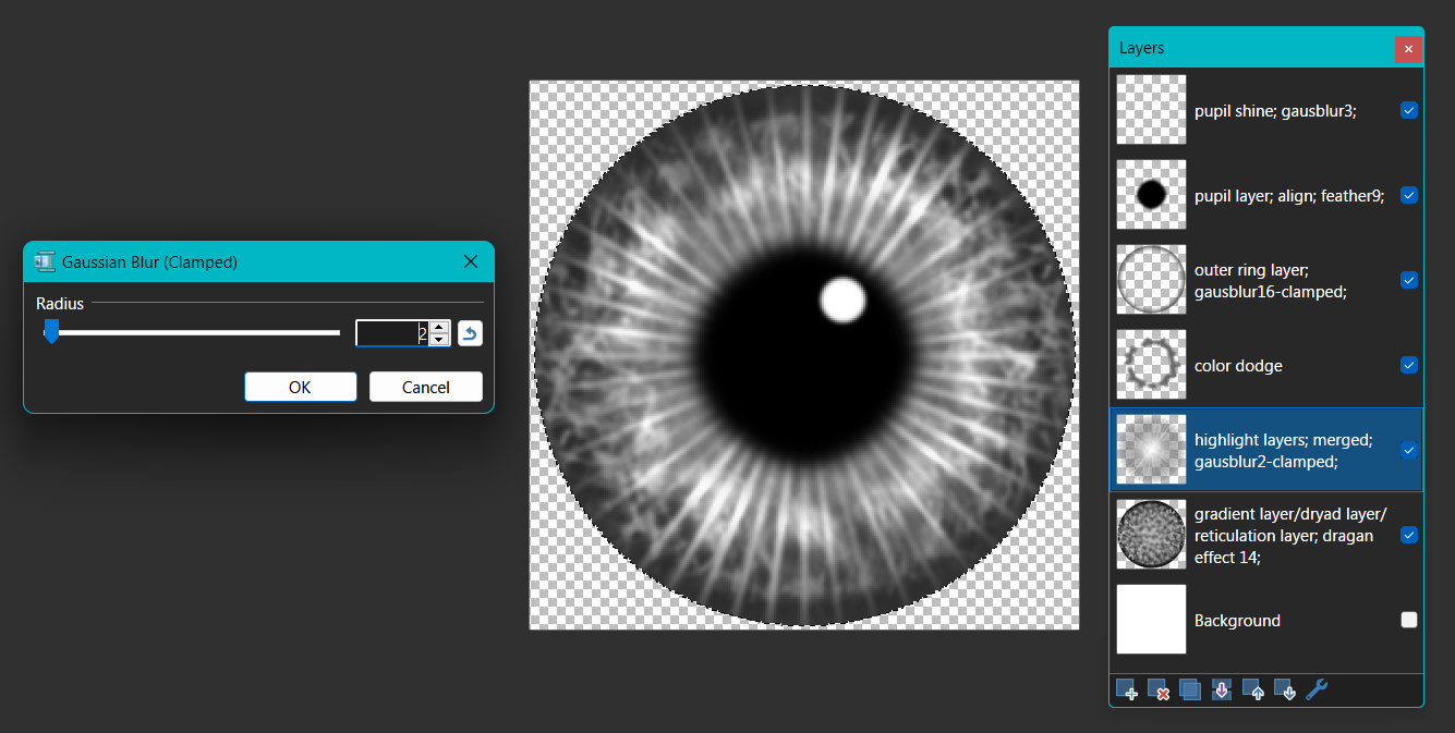

Popular Post lynxster4 Posted September 14 Popular Post Share Posted September 14 Hello everyone! We will be making this: Plugins needed: Dryad and Highlight (found in Red ochre's pack) Donut (found in Madjik's pack) Sharpen+ (by tanel) AA's Assistant (found in dpy's pack) Gaussian Blur-clamped (by toe_head) Feather (found in Boltbait's pack) Gaussian Blur - Built in Reticulation and Dragan Effect (found in ReMake's pack) Spoiler New Canvas 252 x 252, transparent layer, Primary Color – 64,64,64 Shapes – Draw circle 240 x 240, 8 px thick, Align, add new layer below. On Ring layer, select, invert, move back to new layer. Set Primary Color to 192,192,192 and Secondary Color to 32,32,32. Gradient Tool – Radial, offset 116x0. Add new layer above gradient layer. Keep Primary Color set to 192,192,192. On new layer Effects-->Iterative Lines-->Dryad at the settings below: Trunk Position – 0.00, 2.00 Iterations – 8 Trunk Start Width – 0.10 Branch End Width – 1.00 Overall Size – 30.85 Length Change Ratio – (-2.51) Start Deviation Angle – 37.53 End Deviation Angle – 21.54 Alternate Branching – 5.02 Outline Width (Primary) – 0.00 Fill Colors – Primary Check ‘Fill Color Smooth Gradient’ Curve – 0.00 Randomness – 0.00 Deselect, duplicate Dryad layer, flip bottom layer vertically. Merge Dryad layers. Magic Wand (50% for this whole tut) the Ring layer, invert, go to Dryad layer and Distort-->Donut at 124,0,15.3,2,0, mode-medium, 0,0. Keep selected and apply Photo-->Sharpen+ at 500,100,0,100,0 on Dryad layer. Apply an AA’s Assistant at 1,2,1.00. Keep image selected. On Dryad layer apply Effects-->Blurs-->Gaussian Blur-clamped at 1. On Ring layer apply another Gaussian Blur-clamped at 16 then deselect. Add new layer on top for pupil, color black (0,0,0). Paintbrush size - 125, click a couple of times, Align and Effects-->Object-->Feather at 9. (You can make the pupil larger if you wish) Add new layer on top for pupil shine, white (255,255,255). Paintbrush size – 25, then apply Effects-->Blurs-->Gaussian Blur at 3. Merge Dryad layer down onto Gradient layer. Add new layer above Gradient/Dryad layer. Select Gradient layer, invert, go back to new layer and apply Effects-->Artistic-->Reticulation at 26,12,multiply. Apply Effects-->Object-->Feather at 10. Set layer opacity to 130. Merge Reticulation layer down onto Gradient/Dryad layer. Add new layer above Grad/Dryad/Reticulation layer and set mode to Color Dodge. Set Primary color to 96,96,96. Paintbrush size – 25, Hardness 0%. Paint small circles a bit away from the pupil. Try to highlight the clumps of white in the Grad/Dryad/Reticulation layer. Add new layer above Grad layer. Set Primary and Secondary Colors both to white (255,255,255). Select Grad/Dryad/Reticulation layer, invert. Go back to new layer and apply Effects-->Render-->Highlight at 0.00, 0.00, 0.00, 0.00, 18.00, 17.22, 12.00, 1.5, 3.20, water glint, tint-white, 255. Deselect after applying. Duplicate Highlight layer, rotate one layer 15°. Duplicate the rotated layer and rotate another 15°. Merge all Highlight layers. Duplicate merged Highlight layer and rotate one layer 7.50°. Merge all Highlight layers. On Grad/Dryad/Reticulation layer apply Effects-->Artistic-->Dragan Effect at 14. Select Grad/Dryad/Reticulation Layer, invert and go to Highlight layer. Apply Effects-->Blurs-->Gaussian Blur-clamped at 2, then deselect. On Highlight layer, Effects-->Object-->Feather at 20. Uncheck Highlight layer and move Color Dodge layer below Highlight layer. Then merge Color Dodge layer down onto Grad/Dryad/Reticulation layer. Merge pupil shine layer down onto pupil layer. Delete white background layer. Re-check the Highlight layer. You should be left with (4) layers. SAVE THIS .PDN FILE!!! The bottom three layers can then be tinted independently and blend modes changed to achieve a large variety of iris colors. I hope you enjoyed this tutorial. I know it's pretty involved, but yields a good result. All comments are welcome. Thank you. 9 1 Quote My Art Gallery | My Shape Packs | ShapeMaker Mini Tut | Air Bubble Stained Glass Chrome Text with Reflections | Porcelain Text w/ Variegated Coloring | Realistic Knit PatternOpalescent Stained Glass | Frosted Snowman Cookie | Leather Texture | Plastic Text | Silk Embroidery Visit my Personal Website "Never, ever lose your sense of humor - you'll live longer" Link to comment Share on other sites More sharing options...
Chowie Posted September 15 Share Posted September 15 (edited) I love this! I ran a light round of Dents on the highlight layer, I didn't like the way the perfectly straight lines looked. I also ran Bulge on the reflection layer to give it a curve. Edited September 15 by Chowie 2 Quote Link to comment Share on other sites More sharing options...
