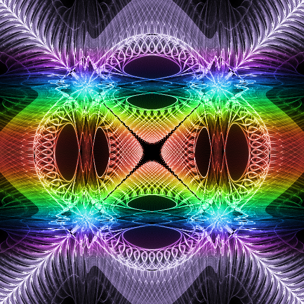

This filter will generate a Popcorn Fractal on your canvas. It is computationally-intensive (Special note for that below).
Preview:
h8LoE6gGS2vRbihcB-M4FYzsa-u_tZXIIefbHt38
How to use:
1. Download Plugin -Popcorn Fractal.zip
2. Install into Paint.NET
3. Load Paint.NET and go into Effect->Render.
4. See how parameters work and change them until your desired result comes.
- Parameters -
Points - Amount of times a point will be calculated per subpixels
Density -  The size of subpixel.
H - Main Internal Function Multiplier
K - Trigonometric Function Multiplier
Zoom - Scale of Fractal
Angle - Angle of Fractal
Origin - Location of coordinate 0,0 in respect to canvas center
Trig Mode - Defines whether to use Trig-4 or Trig-6
X-S - First Trigonometric Function for X-Axis
X-T - Second Trigonometric Function for X-Axis
X-U -Third Trigonometric Function for X-Axis (Unavailable for Trig-4)
Y-S - First Trigonometric Function for Y-Axis
Y-T - Second Trigonometric Function for Y-Axis
Y-U -Third Trigonometric Function for Y-Axis (Unavailable for Trig-4)
Midpoint Shift - Shift Value toward 0 or 1 depending of whether this value is negative or positive
Multiplier - Multiply the value of Fractal. Only Applicable if norm is false.
Normalize - Just as name said. It results in 0-255.

I had some fun playing with this!  Thanks @Reptillian
After many iterations - I ran into a problem resetting the dropdown controls. Would it be possible to add a Reset button which covers all the controls?
14 minutes ago, Ego Eram Reputo said:
After many iterations - I ran into a problem resetting the controls. Would it be possible to add a Reset button?
I don't really have that much knowledge to do so, and c# isn't exactly what I'll be focused on. So, no unless you can give a example on making that, I will try to add a reset button.
Edited by Reptillian
G'MIC Filter Developer
@Reptillian  I had some fun playing with this plugin. The results yield a lot of glassy-looking threads. Different blend modes and some coloring, voila!
 Thanks for making this!  😊
