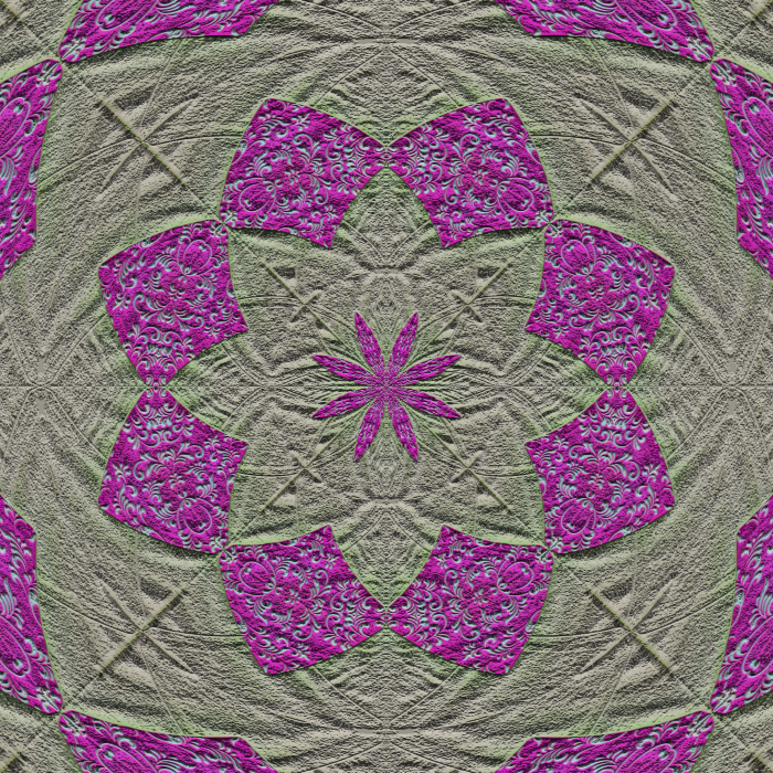

Here's an initial image. I've outlined each edge so you can see how everything transforms, however I'll show off the smoothness of the effect later in this post.
This is the basic setting. 6 pieces, a decent amount of zoom, everything reflecting. Notice that the purple and green edges don't touch, nor do the red and yellow edges. Everything's getting mirrored so the basic effect is smoother.
