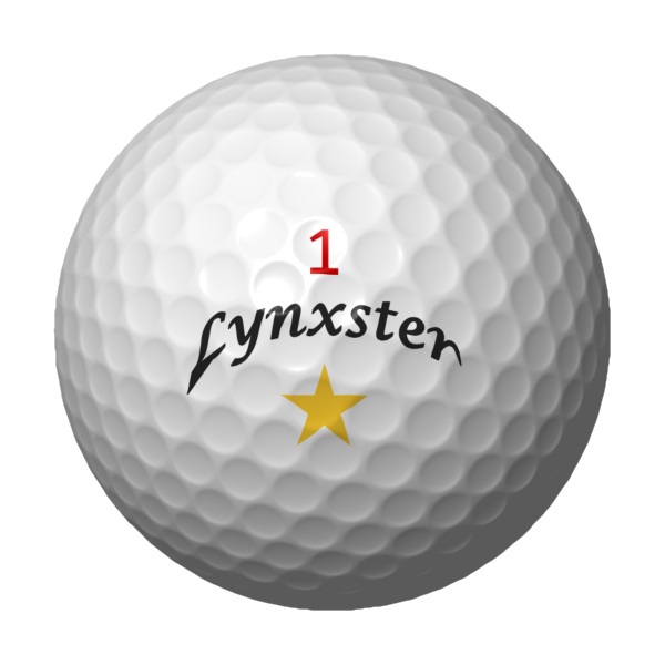

lynxster4 Posted May 7, 2022 Share Posted May 7, 2022 I finally got around to trying this @MJW. Excellent tutorial. Though, I'd like to point out when making the expanded dimple map, 'Merged Height Alpha Source' needs to be set to 'Clipboard Alpha'. I couldn't understand why I wasn't getting an image at all. Here is my attempt: Thank you very much for the tut. 🤩 3 Quote My Art Gallery | My Shape Packs | ShapeMaker Mini Tut | Air Bubble Stained Glass Chrome Text with Reflections | Porcelain Text w/ Variegated Coloring | Realistic Knit PatternOpalescent Stained Glass | Frosted Snowman Cookie | Leather Texture | Plastic Text | Silk Embroidery Visit my Personal Website "Never, ever lose your sense of humor - you'll live longer" Link to comment Share on other sites More sharing options...
MJW Posted May 7, 2022 Author Share Posted May 7, 2022 29 minutes ago, lynxster4 said: I'd like to point out when making the expanded dimple map, 'Merged Height Alpha Source' needs to be set to 'Clipboard Alpha'. Excellent job, ! I really like your custom logo. I'll look into the problem you mention later today. 1 Quote Link to comment Share on other sites More sharing options...
MJW Posted May 8, 2022 Author Share Posted May 8, 2022 Thanks for finding that problem, @lynxster4! I figured out why you encountered it while I didn't. If you start from scratch, as I did, and don't name the layers, the canvas at the point it's expanded is a Background layer, so when it's expanded, the new region is filled with white instead of transparency. Obviously that's not something I should rely on, so it needed to be fixed. There are two possible solutions: change the alpha source in that step, then change it back in the next Texture Merger step; or use the Clipboard (No Displacement) Height Merge Method, which automatically uses clipboard alpha. I chose the second, which seems slightly simpler. I am a bit bugged by a slight inkling that I originally had a reason for selecting Clipboard over Clipboard (No Displacement), but I can't think of what it could possibly be. 1 Quote Link to comment Share on other sites More sharing options...
