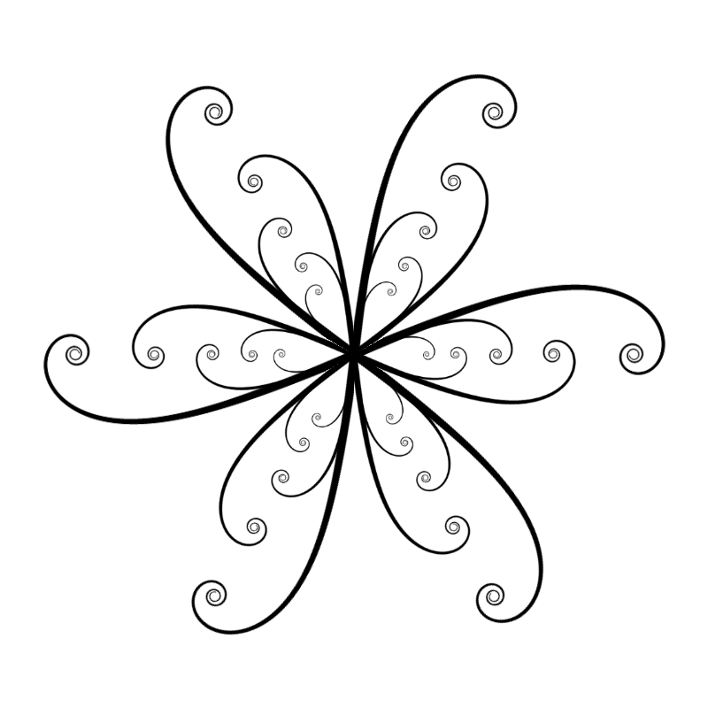

Red ochre Posted February 27, 2021 Share Posted February 27, 2021 (edited) I initially thought it may cause issues with anti-aliasing around objects on some early plugins, however, I cannot find any examples...so hopefully not an issue. Would it create problems with old Pdn files where semi-transparent layers are using blend modes? What is the advantage of changing, other than mathematical 'neatness'? Would file sizes be smaller? The main problem I have is with the way Windows file explorer displays transparency in thumbnails. Sometimes black sometimes white, regardless of the actual values within the png and often changing when the thumbnail display size is changed! - all beyond Paint.net's control. Very frustrating when using black shadows or text on a transparent background and the thumbnail just shows a black square. Curiously 'Optipng' seems to display transparency consistently as white in the Windows thumbnails? From a screenshot of my 'objects' folder:- (Ps. both files have a background of BGRA = 0,0,0,0) Edited February 27, 2021 by Red ochre tested files alpha values Quote Red ochre Plugin pack.............. Diabolical Drawings ................Real Paintings Link to comment Share on other sites More sharing options...

Red ochre Posted February 28, 2021 Share Posted February 28, 2021 2 hours ago, midora said: You are talking about the bKGD chunk in PNG? No, just the pixel values measured with the ink dropper tool. I have no idea about how the information is stored within the png file. I'm happy to upload I have now uploaded both files to my site if you wish to investigate why the Optipng version displays correctly and the standard png, created by Pdn, doesn't. The files can downloaded here: plain png version and the Optipng version I can't find the bKGD chunk when searching through either file in Notepad+. Quote Red ochre Plugin pack.............. Diabolical Drawings ................Real Paintings Link to comment Share on other sites More sharing options...
null54 Posted February 28, 2021 Share Posted February 28, 2021 1 hour ago, Red ochre said: Optipng version displays correctly and the standard png, created by Pdn, doesn't. The Optipng version uses an 8-bit palette with a transparent color index, and the paint.net is saved as 32-bit RGBA. 1 Quote Plugin Pack | PSFilterPdn | Content Aware Fill | G'MIC | Paint Shop Pro Filetype | RAW Filetype | WebP Filetype The small increase in performance you get coding in C++ over C# is hardly enough to offset the headache of coding in the C++ language. ~BoltBait Link to comment Share on other sites More sharing options...
Red ochre Posted February 28, 2021 Share Posted February 28, 2021 Many thanks for taking a look @Null54. Perhaps they were bad example files to choose. I have others in full (24 bit) colour with (8 bit) transparency saved with standard Paint.net .png that also show with a black background in Windows explorer .. and yet others that show a white background? I have even known the thumbnail background to change from black to white when changing thumbnail size or refreshing the Windows explorer view. However it is files with black images on a transparent background that are most problematic for me, so will stick with saving as Optipng for those. I've just read a little about .pngs here I'm currently opening the .png files in Notepad + as 'normal text files' - is there a way to show the numbers or are the byte values always displayed as strange ASC11 characters (I assume)?... I'm new to this! Many thanks (Hope I haven't hijacked your thread @MJW, sorry) Quote Red ochre Plugin pack.............. Diabolical Drawings ................Real Paintings Link to comment Share on other sites More sharing options...
null54 Posted February 28, 2021 Share Posted February 28, 2021 44 minutes ago, Red ochre said: is there a way to show the numbers or are the byte values always displayed as strange ASC11 characters (I assume)? I use a hex editor when examining binary files like images (HxD is one free option). You will not be able to see the pixel color values because PNG files store the image data in a compressed format. 43 minutes ago, Red ochre said: Perhaps they were bad example files to choose. I have others in full (24 bit) colour with (8 bit) transparency saved with standard Paint.net .png that also show with a black background in Windows explorer .. and yet others that show a white background? I do not have any idea what Windows Explorer does when it displays files in its thumbnail view. Some of the WIC (Windows Imaging Component) modes used for resizing images convert images with an alpha channel to premultiplied alpha as part of their processing, so if the image was resized to generate the thumbnail it can result in transparent white being converted to transparent black. 1 Quote Plugin Pack | PSFilterPdn | Content Aware Fill | G'MIC | Paint Shop Pro Filetype | RAW Filetype | WebP Filetype The small increase in performance you get coding in C++ over C# is hardly enough to offset the headache of coding in the C++ language. ~BoltBait Link to comment Share on other sites More sharing options...
