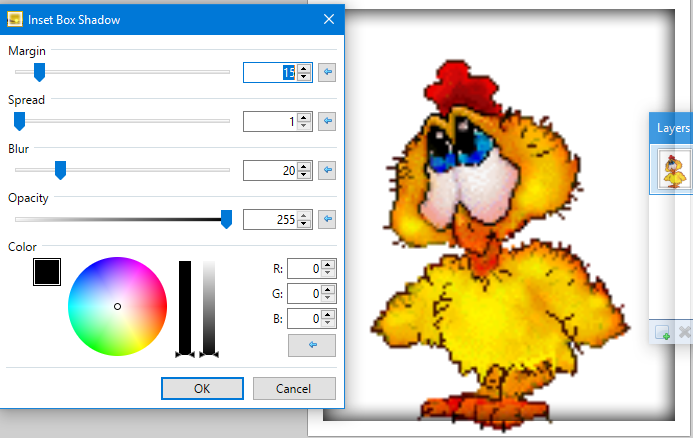

Pixey Posted November 3, 2018 Share Posted November 3, 2018 Hi @neptune1 No video required. Just flatten the image you want to add the grey area to, open Inset Box Shadow and play with the settings: Quote How I made Jennifer & Halle in Paint.net My Gallery | My Deviant Art "Rescuing one animal may not change the world, but for that animal their world is changed forever!" anon. Link to comment Share on other sites More sharing options...
neptune1 Posted November 3, 2018 Author Share Posted November 3, 2018 HI, how do you adjust the shadow image to the same size as the image your trying to add the shadow to? right now the shadow is smaller than my image and I don't see any handles or any way to adjust? Quote Link to comment Share on other sites More sharing options...
Pixey Posted November 3, 2018 Share Posted November 3, 2018 Just decrease the Margin setting Quote How I made Jennifer & Halle in Paint.net My Gallery | My Deviant Art "Rescuing one animal may not change the world, but for that animal their world is changed forever!" anon. Link to comment Share on other sites More sharing options...
IHaveNoName Posted November 3, 2018 Share Posted November 3, 2018 (edited) Pixey beat me to it. The plugin creates a margin by default as shown in Pixey's example. To get rid of it use the slider to reduce the Baseline Margin to "0" (the margin and border will disappear entirely). Then just use the Spread slider to re-introduce the border as wanted. Edited November 3, 2018 by IHaveNoName Quote Link to comment Share on other sites More sharing options...
neptune1 Posted November 3, 2018 Author Share Posted November 3, 2018 ok thanks guys, got that figured out. The image I am adding the shadow to is all white, so what I'd like to do is have it feather in so you can't see any inside edge. I'm noticing an edge near the center, is it possible to feather it into the white? Quote Link to comment Share on other sites More sharing options...
Pixey Posted November 3, 2018 Share Posted November 3, 2018 Try lowering the opacity slider. The faint line is how it's supposed to look when using this Plugin. If you compare the one you posted originally, and my chick, you will see they are the same. Quote How I made Jennifer & Halle in Paint.net My Gallery | My Deviant Art "Rescuing one animal may not change the world, but for that animal their world is changed forever!" anon. Link to comment Share on other sites More sharing options...
