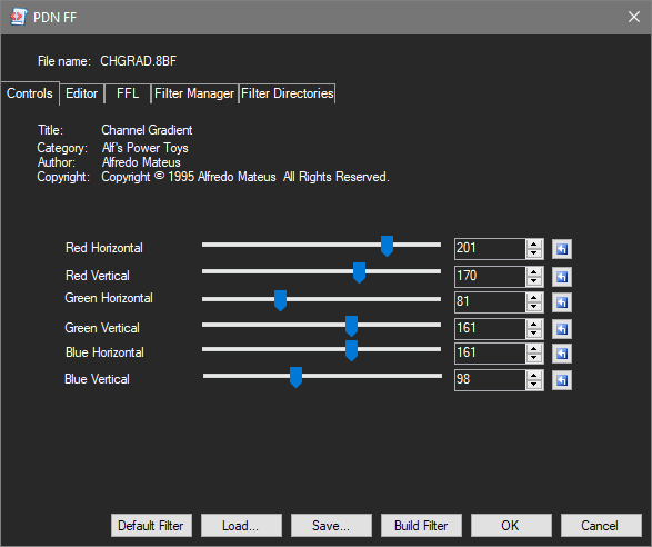

This plugin allow some of the filters built with Adobe's Filter Factory plugin for Photoshop to be run in Paint.NET.
The Filter Factory plugins use a C-style language to modify an image.
If a Filter Factory filter does not work with this plugin you can use PSFilterPdn to run it.
This plugin is compatible with Paint.NET 3.5.11 and 4.0.x.
The Filter Manager will search the directories specified in the directory search list to for filters to display by category.
The Build Filter button will build the loaded filter as a separate plugin for Paint.NET to use.

I've also tried it. Downloaded some simple looking bevel filters from the linked site and got them loaded into the plugin OK.
All I get are various horisontal distortions, no matter which of the filters I apply :(
@null54: Can you add a handful of filters so we can see it working? I would also like to see some documentation. Controls named ctl(4) or Map(2) don't exactly scream their function at me.
It does look very promising, but first impressions are...., daunting!

The zip has been updated with the official documentation and example code.

I'm still not getting anything more than the same horisontal distortions, regardless of which filter I apply....,
Do you have a screenshot of this?
The output of the Filter Factory Example.afs filter should be:
If not I am have no idea what the problem is. :/

Well, didnt use the Filter Factory Example.afs but i assigned the red channel to all channels except A and the output was
those are the horizontal things  :/
The cause of the banding was a thread collision issue, that is now fixed.
That is what I get for not testing on a multi-core machine. :roll:

The samples have been changed to the ones from Filter Foundry so they should now work correctly.

The attached filters do work. Quite well actually. B)
Octagon and Wobble-2d are rather nice!
It seems that all of the other filters have problems so I've just deleted them. I'll download one or two others just to see that they also work before giving this the thumbs up.
Edit: 'Build Filter' is non functional :(.

All the supplied filters are functional, and the 'build effect' also seems to be working. So, as all seems to be well with this plugin...,

Comments: On initial install (copy PdnFF.dll and ffparse_x86.dll to Effects folder) the effect crashes with a
Could not find a part of the path 'C:\Users\Patrick\Documents\Paint.NET User Files\PdnFF.xml' error.
Manually adding a Paint.NET User Files folder made all well.
The Build Filter DLL function worked perfectly, however the Save... as .txt failed and the Save... as .afs was only partially successful with the equations being saved, but not the header info nor the slider info.
I use Filter Factory to make grayscale gradients for use as templates for transitions for Movie Maker. Here is an example and test case: Rotating Bands

As an equation writer, it would be nice if the syntax checking were done on each keystroke to catch mistakes as they occur.
The afs format only saves the slider values and source code, this is because it only asks for that information when the filter is built. :(
It should now create the User data directory of it does not find it.
The save txt function has been fixed and the syntax check now runs as you type.
