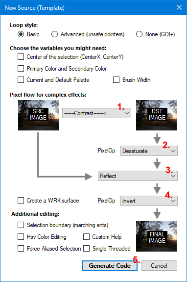

ReMake Posted January 2, 2019 Share Posted January 2, 2019 2 hours ago, Sakana Oji said: I'd really like to make a simple plugin of this with Codelab, but I don't know the codes for "Black and White" and "Curves" There is no need to apply the Curves effect. Try applying the Brightness / Contrast effect by setting one of the options to -1. In this case, creating an effect in CodeLab should not be difficult. Run CodeLab -> File -> New. Select the options as shown below and click Generate. Now you have this code: Spoiler // Name: // Submenu: // Author: // Title: // Version: // Desc: // Keywords: // URL: // Help: #region UICode IntSliderControl Amount1=10; // [-100,100] Brightness IntSliderControl Amount2=10; // [-100,100] Contrast #endregion // Setup for calling the Brightness and Contrast Adjustment function BrightnessAndContrastAdjustment bacAdjustment = new BrightnessAndContrastAdjustment(); PropertyCollection bacProps; // Setup for using pixel op private UnaryPixelOps.Desaturate desaturateOp = new UnaryPixelOps.Desaturate(); private UnaryPixelOps.Invert invertOp = new UnaryPixelOps.Invert(); // Setup for using Reflect blend op private BinaryPixelOp reflectOp = LayerBlendModeUtil.CreateCompositionOp(LayerBlendMode.Reflect); protected override void OnDispose(bool disposing) { if (disposing) { // Release any surfaces or effects you've created. if (bacAdjustment != null) bacAdjustment.Dispose(); bacAdjustment = null; } base.OnDispose(disposing); } void PreRender(Surface dst, Surface src) { bacProps = bacAdjustment.CreatePropertyCollection(); PropertyBasedEffectConfigToken bacParameters = new PropertyBasedEffectConfigToken(bacProps); bacParameters.SetPropertyValue(BrightnessAndContrastAdjustment.PropertyNames.Brightness, Amount1); bacParameters.SetPropertyValue(BrightnessAndContrastAdjustment.PropertyNames.Contrast, Amount2); bacAdjustment.SetRenderInfo(bacParameters, new RenderArgs(dst), new RenderArgs(src)); } // Here is the main render loop function void Render(Surface dst, Surface src, Rectangle rect) { // Call the Brightness and Contrast Adjustment function bacAdjustment.Render(new Rectangle[1] {rect},0,1); // Now in the main render loop, the dst canvas has an adjusted version of the src canvas for (int y = rect.Top; y < rect.Bottom; y++) { if (IsCancelRequested) return; for (int x = rect.Left; x < rect.Right; x++) { ColorBgra CurrentPixel = dst[x,y]; // TODO: Add additional pixel processing code here CurrentPixel = desaturateOp.Apply(CurrentPixel); CurrentPixel = reflectOp.Apply(src[x,y], CurrentPixel); CurrentPixel = invertOp.Apply(CurrentPixel); dst[x,y] = CurrentPixel; } } } Move line "CurrentPixel = reflectOp.Apply(src[x,y], CurrentPixel);" under line "CurrentPixel = invertOp.Apply(CurrentPixel);" Replace Amount1 and Amount2 with 0 and -1 respectively in these lines: bacParameters.SetPropertyValue(BrightnessAndContrastAdjustment.PropertyNames.Brightness, 0); bacParameters.SetPropertyValue(BrightnessAndContrastAdjustment.PropertyNames.Contrast, -1); You can now remove the Amount1 and Amount2 controls - you will no longer need them. Fill in the commented lines at the top of the codes, for example: Spoiler // Name: Colors Intensity // Submenu: Color // Author: // Title: Colors Intensity // Version: 1.0 // Desc: Give the picture an intense colors // Keywords: intensity|color // URL: http://www.getpaint.net/redirect/plugins.html and save your effect. I hope it's not difficult. 1 Quote Link to comment Share on other sites More sharing options...
