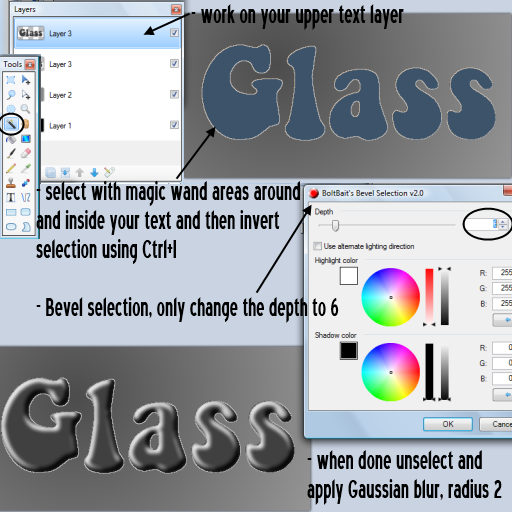

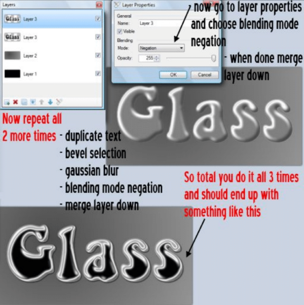

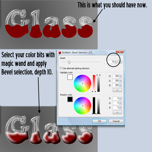

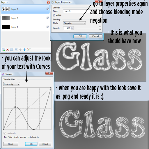

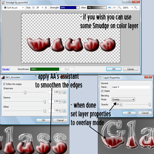

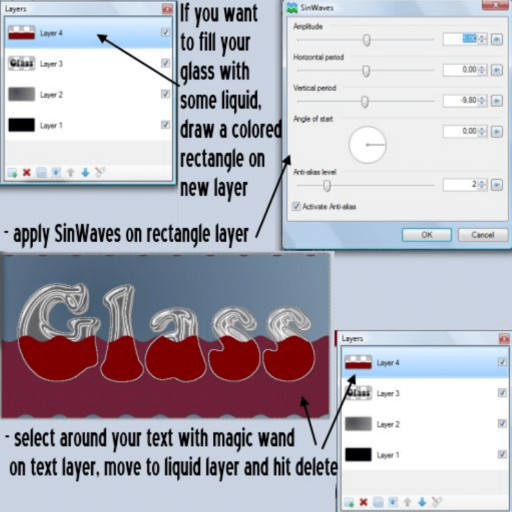

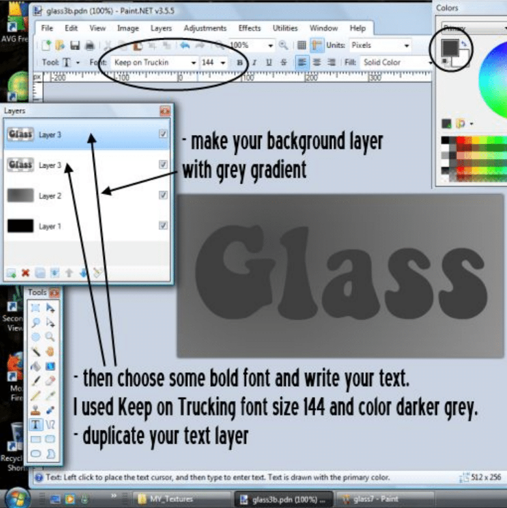

Ella Posted November 22, 2010 Share Posted November 22, 2010 This tutorial is available as a PDF. Click here to view or download it I found this psd tutorial here and wanted to create something similar with Paint.net. I think the outcome isń´t too bad but let me know if the tutorial is not ok as I am fairly new to this . I used in this tutorial: Layer blending modes Gaussian Blur Curves Bevel Selection Smudge Aa´s Assistant SinWaves This is the final image with the text: And these are the steps to get there, I tried to make them compact to cut down on amount of images, let me know if they are too compact : 5 Quote Link to comment Share on other sites More sharing options...

Ella Posted December 5, 2010 Author Share Posted December 5, 2010 (edited) I think too it came out good . I used Curves to adjust the look of the glass. Edited December 5, 2010 by Ella Quote Link to comment Share on other sites More sharing options...
