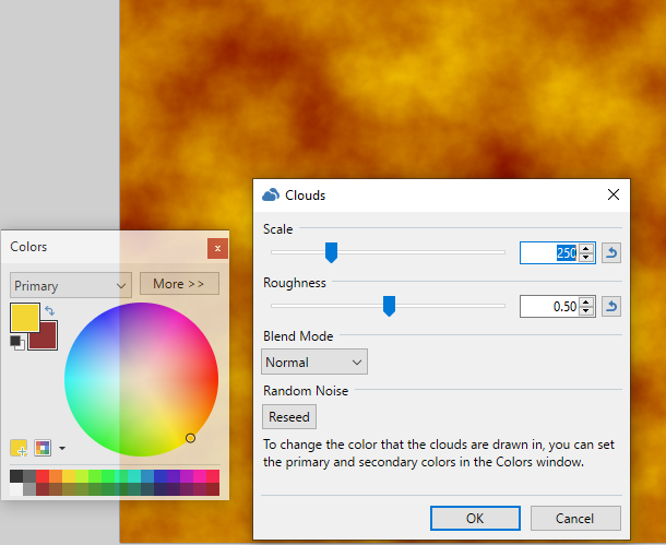

Pixey Posted July 28, 2022 Share Posted July 28, 2022 You can use the Clouds Plugin: Quote How I made Jennifer & Halle in Paint.net My Gallery | My Deviant Art "Rescuing one animal may not change the world, but for that animal their world is changed forever!" anon. Link to comment Share on other sites More sharing options...

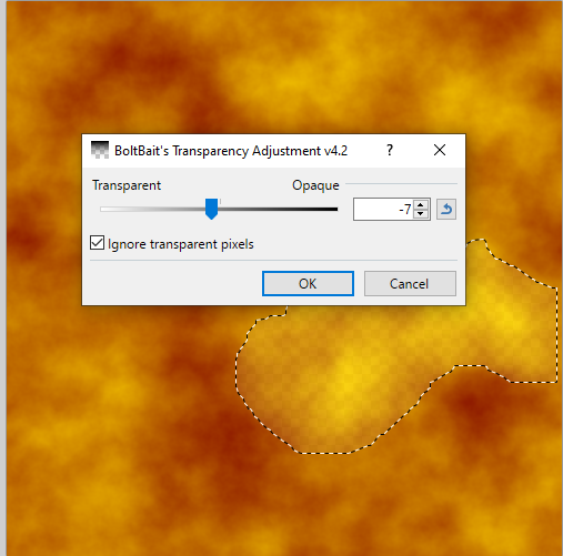

Pixey Posted July 28, 2022 Share Posted July 28, 2022 You could 'select' the area and then use @BoltBait's Transpareny Plugin: Quote How I made Jennifer & Halle in Paint.net My Gallery | My Deviant Art "Rescuing one animal may not change the world, but for that animal their world is changed forever!" anon. Link to comment Share on other sites More sharing options...

Solution Ego Eram Reputo Posted July 28, 2022 Solution Share Posted July 28, 2022 2 hours ago, Lasse Edsvik said: Is there a way to make the white areas more transparent before applying that? Ref Pixey's image above. When you've set ther Primary color to yellow, open the More tab in the Colors window and reduce the transparency of the yellow shade. Then render the clouds. That will make the brighter areas of the texture more transparent. Quote ebook: Mastering Paint.NET | resources: Plugin Index | Stereogram Tut | proud supporter of Codelab plugins: EER's Plugin Pack | Planetoid | StickMan | WhichSymbol+ | Dr Scott's Markup Renderer | CSV Filetype | dwarf horde plugins: Plugin Browser | ShapeMaker Link to comment Share on other sites More sharing options...
