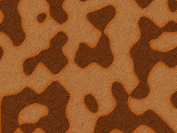

cjmcguinness Posted April 7, 2007 Share Posted April 7, 2007 This tutorial is available as a PDF. Click here to view or download it Moderators Note: Images have been rehosted by ReMake. We're going to create a kind of Animal Skin style Fur Texture with a random pattern. Start with a canvas size of 800 x 600 Click the More >> button in the Colors toolbar and set your primary color to a Hex value of AC703D Fill your Background with this color. Add a new layer - set your Primary color to Black and Secondary color to White EFFECTS > Clouds - Scale 200, Roughness 10. CTRL+F to repeat Clouds ADJUSTMENTS > Brightness / Contrast - Brightness 10, Contrast 100. Use the Magic Wand tool to select all the white area (hold SHIFT while you select) and delete Use the Magic Wand tool again to select all the black areas (again, holding SHIFT while selecting) Set your Primary color to Hex: B14D03 Fill all the black areas with this color Duplicate this layer. Change your Primary color to Hex 64300A and fill the selected areas with this color. Press CTRL+D do deselect. Go to the middle layer and apply EFFECTS > BLURS > Gaussian Blur with a radius of 25. Duplicate this layer then flatten the image. EFFECTS > Add Noise - Intensity 50, Color Saturation 0. EFFECTS > BLURS > Motion Blur - Angle 45.00, Distance 6. CTRL+F to repeat Motion Blur. If you increase the intensity of the Noise you can adjust the roughness of the fur. Try adding lighting/shading effects. Quote Link to comment Share on other sites More sharing options...

NotAulophobic Posted April 8, 2007 Share Posted April 8, 2007 The animal-obsessed part of my brain is begging to say something... It looks more giraffe than leopard. Leopards have circles, not random blobs. Blobs are on the giraffes. Other than that, though, it looks really great! Kudos to you! Quote Link to comment Share on other sites More sharing options...
cjmcguinness Posted April 8, 2007 Author Share Posted April 8, 2007 The animal-obsessed part of my brain is begging to say something...It looks more giraffe than leopard. Leopards have circles, not random blobs. Blobs are on the giraffes. Other than that, though, it looks really great! Kudos to you! You're probably right! I just wanted to do something with a random pattern. You could easily draw some 'Leopard' style spots rather than doing the Clouds to make it more Leopardskin. Quote Link to comment Share on other sites More sharing options...

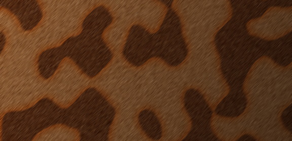

Boo Posted April 10, 2007 Share Posted April 10, 2007 yeah really nice ^^ here is mine did exactly what you said but only black dots (think thats more realistic but hey thats my opinion^^) *edit: use sharpen for a more 'realistic' fur you can actually see the hairs then but when using to much it looks nice but around the dot's comes a glow :s:s:( Quote Link to comment Share on other sites More sharing options...
Down Posted April 10, 2007 Share Posted April 10, 2007 Cool. Yours looks more lepordish. Quote •♪♫♥♫♪• |- The Rules -|- çobblestones -|- CaMo -|- MeTaL -| ╠═╧╨»Φ«╨╤═╣ Link to comment Share on other sites More sharing options...

cjmcguinness Posted April 11, 2007 Author Share Posted April 11, 2007 Here's my latest version of this: I made the background colour lighter and used spots for a more Leopardskin feel. Quote Link to comment Share on other sites More sharing options...
