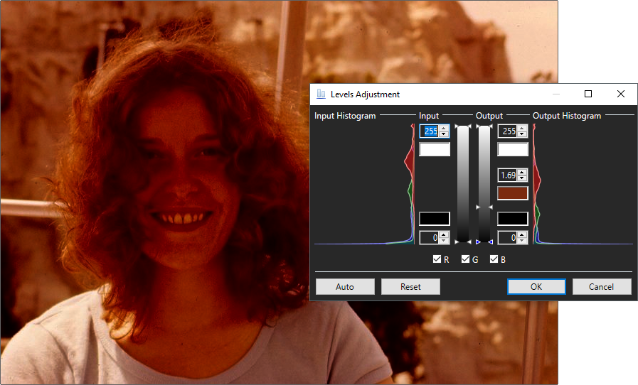

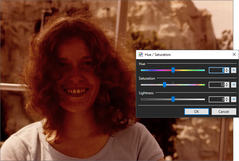

Ego Eram Reputo Posted January 30, 2019 Share Posted January 30, 2019 Here's my take: Open Adjustments > Levels and move the middle Output slider down to the indicated position. Next open Adjustments Hue & Saturation and lower the saturation down to around 72. Quote ebook: Mastering Paint.NET | resources: Plugin Index | Stereogram Tut | proud supporter of Codelab plugins: EER's Plugin Pack | Planetoid | StickMan | WhichSymbol+ | Dr Scott's Markup Renderer | CSV Filetype | dwarf horde plugins: Plugin Browser | ShapeMaker Link to comment Share on other sites More sharing options...

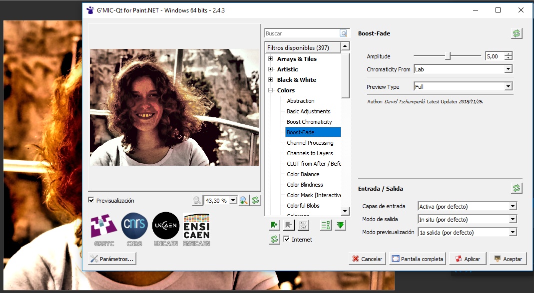

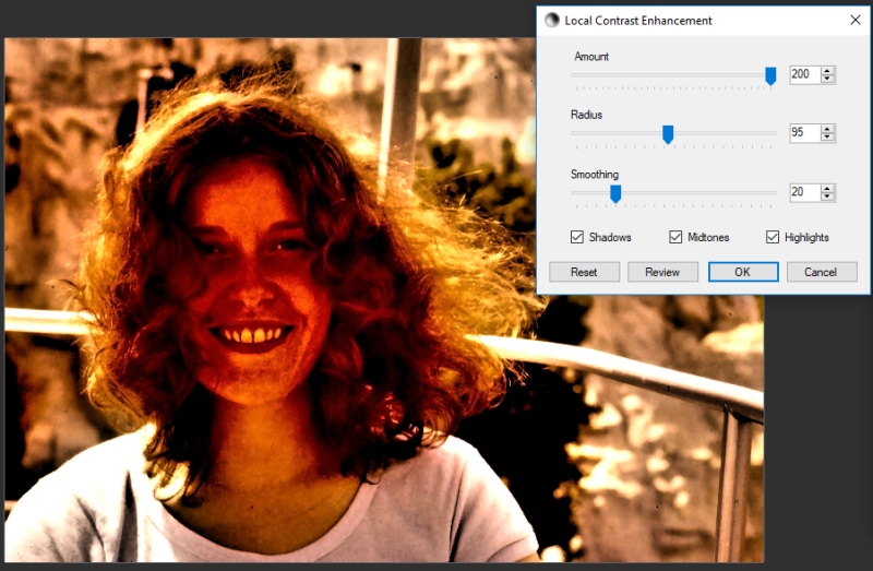

Maximilian Posted January 31, 2019 Share Posted January 31, 2019 I first ran Surface Blur with a Radius of 1 and a Threshold of 5 to reduce some of the graininess on her face. Then I applied Local Contrast Enhancement as shown in the pic below: The result is this: Then I ran G'MIC (Boost-Fade filter with settings as shown below): Which resulted in this: (There's still a good amount of graininess on her face, so these are intended merely as possible starting points for further improvement) Alternatively, I also tried applying the Boost-Fade filter alone, with no previous effect, but I think the outcome turned out rather colorless, although her face seems to look a bit less grainy than with the previous method: So, in order to enhance colors, I applied the Laplacian Pyramid Filter with an Outlier reduction of 50 and an Extra contrast of 0.55 (all other settings at defaults), rendering the following result: I tried other methods as well, but didn't like the outcomes very much. I hope my take on the matter may help somehow (I feel I prefer the second method but that's up to each eye's taste). 1 Quote Link to comment Share on other sites More sharing options...
