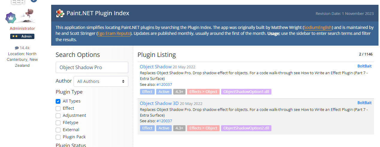

I believe it has been replaced by Shadow 3D.  You can view this in the Plugin Index
I checked Object Shadow 3D in the Plugin Index and it re-directs me to Bolt Bait's antiquated plugin pack for PdN v4.3.10 - 4.3.12. Regardless of this fact, I installed the plugin and only checked "ObjectTools.dll" in the installer, unfortunately though the plugin wasn't present when I opened PdN. Also, Bolt Bait's latest plugin pack doesn't even include this plugin as well so I'm kind of stuck in a dilemma here.
