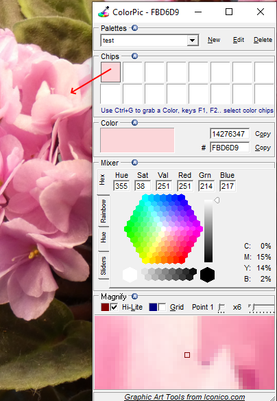

I've never seen anything like that, that gives the actual name of the color.  But, there is an App that I use, that gives you the color #'s.  http://www.iconico.com/colorpicker/
I use it quite a bit and it works like this:
You can generate pallets online too, if you begin with a color, then it gives you matching shades:  https://mycolor.space/?hex=%23845EC2&sub=1
