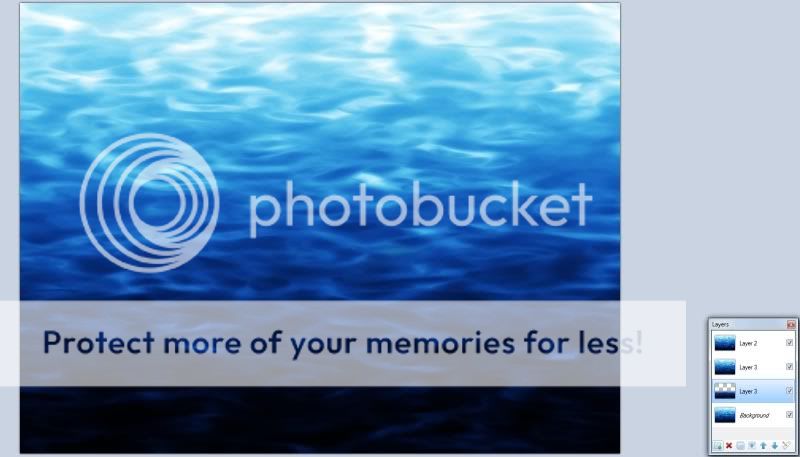

15. Copy (shortcut: Ctrl+C) and paste onto a new layer (shortcut: Ctrl+Shift+V) and change the Blend Mode of the new layer to Darken (double click layer > Blending > Darken).
16. Move (shortcut: M) the copy horizontally (click and hold on the image the use the left and right arrow keys) until you get something that looks watery.
Posted Image
17. Select a new part of the bottom layer, copy (shortcut: Ctrl+C) and paste onto a new layer between the current layers (shortcut: Ctrl+Shift+V).
17. Select all of the bottom layer, copy (shortcut: Ctrl+C) and paste onto a new layer between the current layers (shortcut: Ctrl+Shift+V).

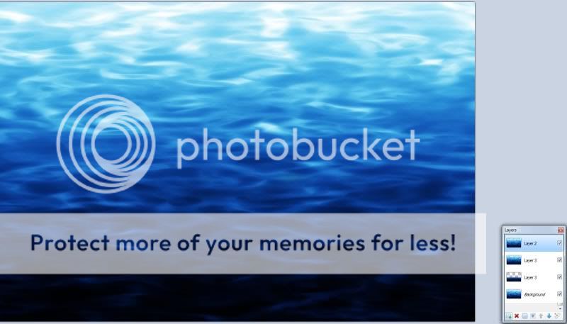

18. Set middle layer’s Blend Mode to Lighten (double click layer > Blending > Lighten) and Move (shortcut: M) it directly behind the other copy.
Posted Image

21. Set Blend Mode of the layer second from the bottom to Darken (double click layer > Blending > Darken).
22. Draw a transparent gradient from the second fifth from the bottom of the image to about halfway (hold shift to keep the gradient straight).
Posted Image
23. If the water looks too wavy you can increase the width of the image.
Posted Image
