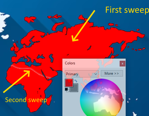

Sickminecraft45 Posted June 20, 2023 Share Posted June 20, 2023 When I use the recolour tool, these lines and gaps appear. What's causing them and how do I resolve it? Quote Link to comment Share on other sites More sharing options...
Lemonade Posted June 20, 2023 Share Posted June 20, 2023 (edited) Change from Antialiased to Aliased rendering (Recolor Tool options at the top - 5th icon after Tolerance, or 2nd from the right). "The Recolor Tool can be rendered with an aliased (jagged) or antialiased (smoothed) edge. This toggle selects which mode will be used. If aliasing is selected, the Hardness setting will be ignored."https://www.getpaint.net/doc/latest/RecolorTool.html Edited June 20, 2023 by Lemonade additional info 1 Quote Link to comment Share on other sites More sharing options...
Pixey Posted June 20, 2023 Share Posted June 20, 2023 @Sickminecraft45 welcome to the forum Also, you need to do your 'sweep' of the brush only once, otherwise there will be a line when you go over for the second time. 1 Quote How I made Jennifer & Halle in Paint.net My Gallery | My Deviant Art "Rescuing one animal may not change the world, but for that animal their world is changed forever!" anon. Link to comment Share on other sites More sharing options...
