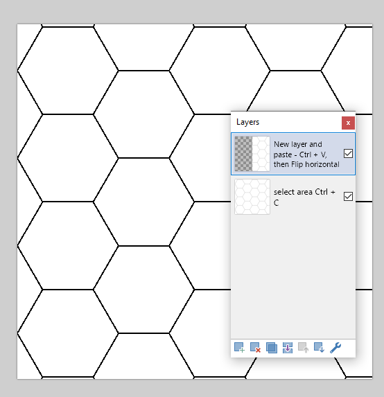

Pixey Posted 5 hours ago Share Posted 5 hours ago (edited) Hello @PaulHo and welcome to the forum What not try this: 1. Select the area with Rectangle select and then Ctrl + C. 2. Make a new layer and then Ctrl + V 3. Then use Flip Horizontal. Edited 2 hours ago by Tactilis Fixed accidental typing of Ctrl + P (instead of Ctrl + V) at step 2 Quote How I made Jennifer & Halle in Paint.net My Gallery | My Deviant Art "Rescuing one animal may not change the world, but for that animal their world is changed forever!" anon. Link to comment Share on other sites More sharing options...
Tactilis Posted 2 hours ago Share Posted 2 hours ago 3 hours ago, Pixey said: 3. Then use Flip Horizontal. @PaulHo please note that there are two Flip Horizontal (and Flip Vertical) commands: 1. Image > Flip Horizontal Flips the entire image (i.e all layers) 2. Layers > Flip Horizontal Flips only the active layer You need to use the Layers version. See the Documentation here https://www.getpaint.net/doc/latest/index.html (or click the Help icon top right in paint.net) Quote Link to comment Share on other sites More sharing options...
