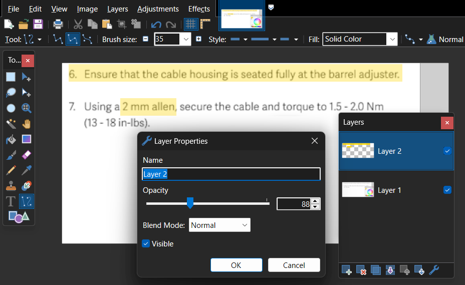

littlebigman Posted January 17 Share Posted January 17 Hello, What's the right way in 2024 to highlight text? What tool should I use after setting Blend mode = Multiply in the Layer Properties (Layers > Layer Properties, shortcut: F4)? The Paintbrush has a bunch of options, provided it is the right tool for the job. Thank you. Quote Link to comment Share on other sites More sharing options...
Solution Tactilis Posted January 17 Solution Share Posted January 17 Use either of these techniques: A. With a separate Layer 1. Use the line tool to draw a line in the layer, with an appropriate brush size. Press Shift while drawing to give a horizontal line. 2. Reduce the layer opacity as required. B. In the same Layer 1. Use the line tool to draw a line, with an appropriate brush size and with the Blend Mode set to Multiply. Press Shift while drawing to give a horizontal line. The advantage of using a separate layer is that you can remove the highlighting at a later time if you wish. 1 Quote Link to comment Share on other sites More sharing options...
littlebigman Posted January 17 Author Share Posted January 17 Thank you. 1 Quote Link to comment Share on other sites More sharing options...
HankP Posted January 18 Share Posted January 18 You can also put the "highlighter" layer UNDER the text layer, and that way you do not need to make it transparent. Quote Link to comment Share on other sites More sharing options...
Tactilis Posted January 18 Share Posted January 18 5 hours ago, HankP said: You can also put the "highlighter" layer UNDER the text layer Yes, you can do that if you are writing the text on its own transparent layer, which is generally a sensible thing to do. I was assuming that the OP was trying to highlight text on an existing image; i.e that they already had the text and the white background in a single layer. Quote Link to comment Share on other sites More sharing options...
