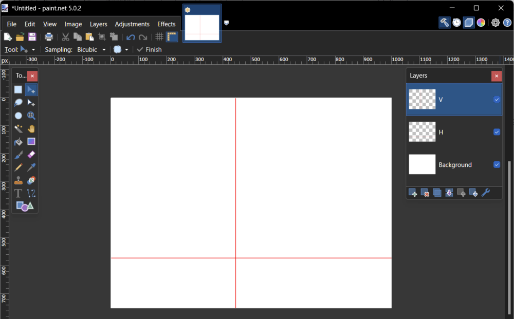

Tactilis Posted February 27 Share Posted February 27 (edited) There's this: And this: But I normally just create a horizontal and vertical line on two new transparent layers above my image and drag them around as needed. It doesn't take long if you use the shortcut keys instead of the mouse:1. Create the horizontal guideline Ctrl+Shift+N (New layer) F4 H Enter (Open the Layer Properties and name the layer H for horizontal) O (Activate the Line/Curve tool) Hold down Shift and draw a horizontal line.2. Repeat the above to create the vertical guideline layer (name it V) 3. Move a guideline Alt+Page Up/Down (Set the H or V layer active) M (Activate the Move Selected Pixels tool) Use the mouse to drag the guideline layer to where you want it to be, or use the arrow keys (or Ctrl+arrow) for small adjustments. Ctrl+D (Deselect) Alt+Page Up/Down (Set your image layer active) The sequence in step 3 is very quick and can be repeated whenever you wish to reposition a guideline. Edited February 27 by Tactilis Add image 1 Quote Link to comment Share on other sites More sharing options...

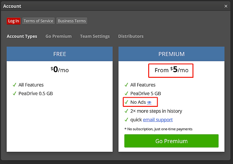

Tactilis Posted February 27 Share Posted February 27 2 hours ago, Chilly_Bang said: To see an example look please into photopea. The draggable/snappable guidelines are nice and Paint.NET would certainly benefit from similar - but to be fair, Photopea is not a free editor, unless you are OK with Ads: Quote Link to comment Share on other sites More sharing options...
