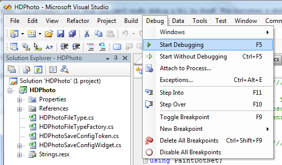

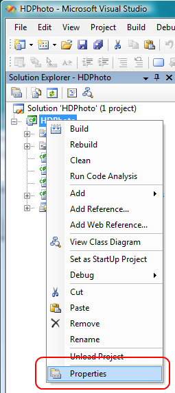

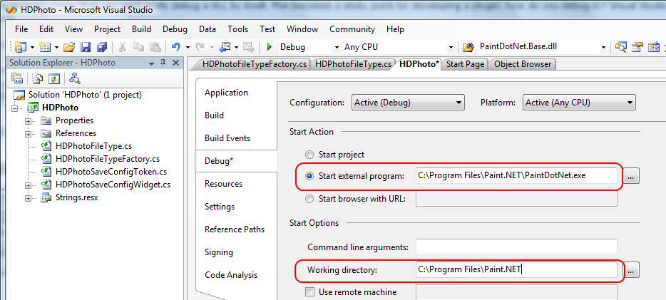

Rick Brewster Posted May 26, 2007 Posted May 26, 2007 If you've written a plugin DLL with Visual Studio, you probably know that you can't really debug a DLL by itself. This becomes a sticky point for developing a plugin: how do you debug it!? Visual Studio has excellent facilities for debugging when you are launching an EXE, but for your plugin DLL it's a little more confusing. Note: These instructions do not pertain to CodeLab plugins. The trick is to set up your project settings so that you are actually launching Paint.NET! In this post, I will show you how. I have used this myself while developing some of the plugins I've posted in the past (e.g., HD Photo). I'll use the HD Photo plugin an example. You can get the source code for it by downloading the source code for Paint.NET v3.07: http://www.getpaint.net/download.html . It is in the "extras" folder. Edit: The source code has long since been taken down. Please do not ask for it. Thanks. 1. Open up your project file in Visual Studio. (This much should be obvious 8)) 2. Right click on your project in the Solution Explorer and then click on Properties. 3. Click on the "Debug" tab. 4. Click the "Start external program" radio button, and fill in the path to the Paint.NET executable. 5. Make sure to fill in the Working Directory as well. After you complete steps 4 and 5, you should have this: 6. You will want to create a custom Post Build Event that will copy your plugin DLL to the appropriate location. Otherwise Paint.NET won't be able to find your plugin, or it will use an older version. Like so: (Naturally, if you are setting this up for an Effect plugin, make sure to copy it to the Effects directory, not the FileTypes directory!) 7. Set a breakpoint in your code. This isn't a requirement -- I am listing this for illlustration purposes. As you get better with the debugger, or if you're already a ninja, you will do whatever is necessary. 8. And then run Paint.NET with the Debug -> Start Debugging menu item. Now when there is an exception in your plugin, you will be thrown in to the debugger instead of getting a crash dialog. You can then debug it using the standard Visual Studio debugging commands. 3 Quote The Paint.NET Blog: https://blog.getpaint.net/ Donations are always appreciated! https://www.getpaint.net/donate.html

SeriousSam Posted April 8, 2009 Posted April 8, 2009 This is how I was able to get debugging working with VS2008 C# Express Edition What is missing from the express edition is the start external program option. However, it can still be set manually in the "*.csproj.user" file found in the project directory. First I opened up the "*.csproj.user" file in notepad. It looked like: I added the following commands: Program C:\Program Files\Paint.NET\PaintDotNet.exe C:\Program Files\Paint.NET\Effects Make sure these paths are correct for your own system This completes steps 1-5 from Rick's guide. Next open the solution and set the post build event to copy the dll to the Paint.Net\Effects directory (Rick's Step 6) With Vista I found it was necessary to run visual studio as an admin or the file copy in the post build would fail. Setting the run as admin flag in the VCSExpress.exe compatibility properties will cleared this up. Happy debugging Quote

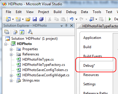

Paul Posted August 28, 2009 Posted August 28, 2009 This is what I got when I went to Debug* Quote Is it really nessecary to put text here? Thought not
Simon Brown Posted August 28, 2009 Posted August 28, 2009 This is what I got when I went to Debug* I'm guessing you're using the express edition? In which case, try SeriousSam's suggestion. Quote
Paul Posted August 28, 2009 Posted August 28, 2009 Part yes. I am but this is Visual Basic I'm running. Is there help for visual basic? Quote Is it really nessecary to put text here? Thought not
