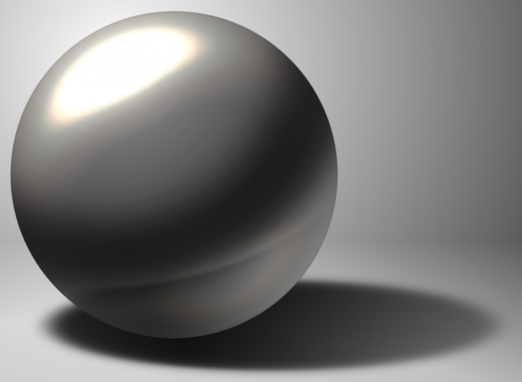

MJW Posted November 26, 2015 Share Posted November 26, 2015 Where's the fun in copy-and-pasting? Here's a pearl I made using Shape3D. It isn't really what I think you (Marilynx) are after, but I like it. 1 Quote Link to comment Share on other sites More sharing options...
MJW Posted November 26, 2015 Share Posted November 26, 2015 It appears to me that the black pearls are primarily reflective. That brings up the question of what should be reflected. It could just be some rather vaguely naturalistic pattern of light and dark, or it could be used creatively to reflect a specific environment. Quote Link to comment Share on other sites More sharing options...

Marilynx Posted November 26, 2015 Author Share Posted November 26, 2015 Where's the fun in copy-and-pasting? Here's a pearl I made using Shape3D. It isn't really what I think you (Marilynx) are after, but I like it. I like it, too! That's an interesting double shadow in your image, along with a very nice pearl. Quote Link to comment Share on other sites More sharing options...
MJW Posted November 26, 2015 Share Posted November 26, 2015 Actually, a shadow and a reflection. Or at least that was my intention. Quote Link to comment Share on other sites More sharing options...

Eli Posted November 26, 2015 Share Posted November 26, 2015 I tried to convert a white pearl into a black one and this is what I got, a bowling ball. 1 Quote Link to comment Share on other sites More sharing options...
Marilynx Posted November 26, 2015 Author Share Posted November 26, 2015 I tried to convert a white pearl into a black one and this is what I got, a bowling ball. Lol! Yes, that was what I was concerned about! It's a very NICE bowling ball, though! Here is one of my attempts in that department. I could not find TR's light plug in, so I used your technique, with black and gray clouds to start with. Then, after doing the 3D fold-sphere, I duplicated the layer with it, set the layer to "glow" and reduced the opacity. Quote Link to comment Share on other sites More sharing options...
