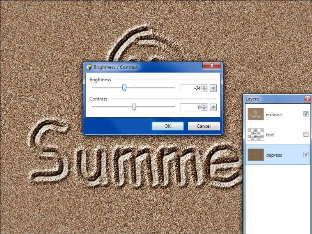

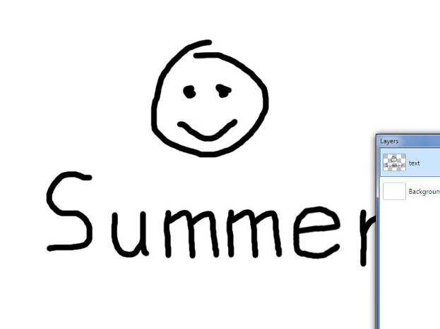

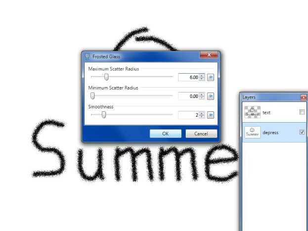

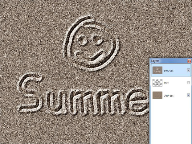

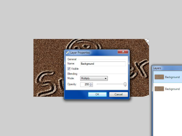

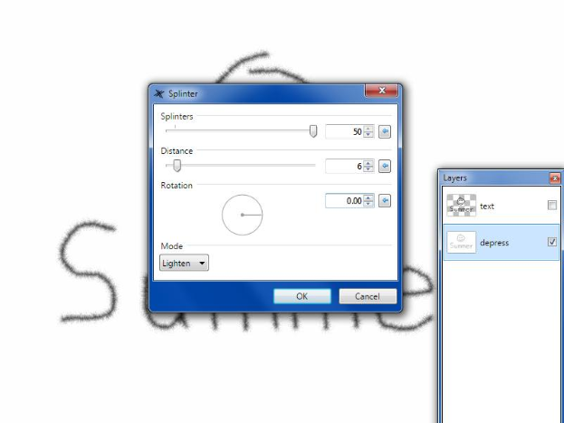

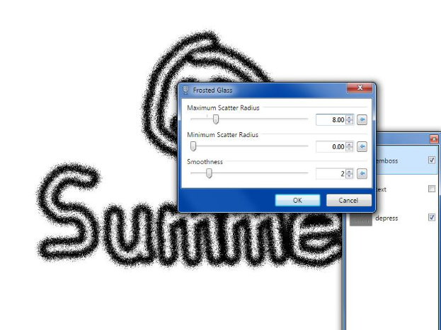

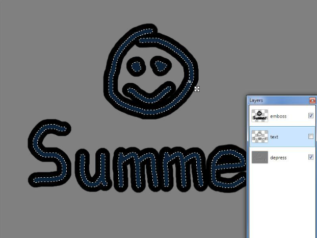

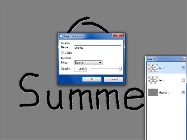

Popular Post yellowman Posted May 8, 2014 Popular Post Share Posted May 8, 2014 This tutorial is available as a PDF. Click here to view or download it How to Write on Sand. In this tutorial we are going to make a text like this: Plugins required for this Tutorial are: 1-Splinter Blur 2-Drop Shadow 1-Open new file 800 x 600 pix, or as desired, add new layer and call it text, write your text or shapes on this layer (free hand style text is more effective, but if you like to use a ready font make sure to choose a thin uniform body type (not much decoration in it): 2-Duplicate the text layer, make the top one invisible and merge the lower one to the white background and call the new resulted layer depress: 3-Run the Frosted Glass on the depress layer with these settings, try not to distort the text too much: 4-Run Splinter Blur plugin on the depress layer with these setting: 5-Emboss the depress layer, it is important here to remember the angle, so pick an easy one to remember: 6-Duplicate text layer and make the top one visible and call it emboss: 7-Add shadow to the emboss layer using Drop Shadow plugin or any available effect; make sure to triple the thickness of the text: 8-With Global flood mode select the text and shapes in the text layer using Magic Wand 9-Make sure the emboss layer is selected (highlighted in the Layers Sub-Window) and the selection is still active then hit delete on your keyboard (so now you should see the depress layer through: We are going to repeat same steps on emboss as we did on depress layer 10-Add new white layer under emboss layer and merge the emboss to the new layer (rename the resulted layer emboss again in case if you lost the name ), then run Frosted Glass effect with these setting or similar (again don’t distort for too much) 11-Run Splinter with these setting: 12-Emboss the emboss layer but make sure to use the opposite direction to the angle than the depress layer: 13-With Global flood mode Magic Wand, select again the text and shapes in text layer (keep the layer invisible): 14-Switch to emboss layer and hit delete on your keyboard: 15-Add Noise to emboss layer: 16-Give a sepia effect to emboss and depress layers (use Paint.NET original Sepia) 17-Saturate the colors of the emboss layer with Hue/Saturation adjustment: 18-Play with brightness and contrast of the depress layer to give it a moisturized sand effect, then flatten the image: The next steps are optional: 19-Tilt, rotate and zoom the image using Layer Rotate/Zoom tool: 20-Select the desired area: 21-And Crop the image: 22-Duplicate the layer and set the blending mode to multiply: 23-Use Linear Gradient with Transparency Mode to fade the top layer, make sure to start from the opposite direction of the light source: 24-Fill any leftover gaps using Clone Stamp tool or any other method, then enhance the saturation if it required: 25-To get this final result: Remeber to add you own effects and touches, these are just the basics Here is another version on the wet sand situation, I used here Dents instead of Frosted glass and added some shadow using Trail plugin: I hope you like it, feel free to ask if you have any question. 13 Quote My GalleryMy YouTube Channel "PDN Tutorials" Link to comment Share on other sites More sharing options...
