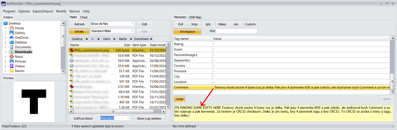

Tactilis Posted October 31 Share Posted October 31 @bflmpsvz If you search for how to add tEXt chunks to png you will find several ways of editing your textual comments. There are various options; some are online tools and others you can run locally. For example the command line tool exiftool will read and write tEXt chunks. If you want a GUI for that then you could use ExifToolGui. Here, I am editing the tEXt chunk comment in your original file: Once @Rick Brewster has added the ability in a later 5.1.x release to preserve PNG-specific metadata, you will have the means of editing PNGs with Paint.NET without losing your tEXt chunks. Quote Link to comment Share on other sites More sharing options...
