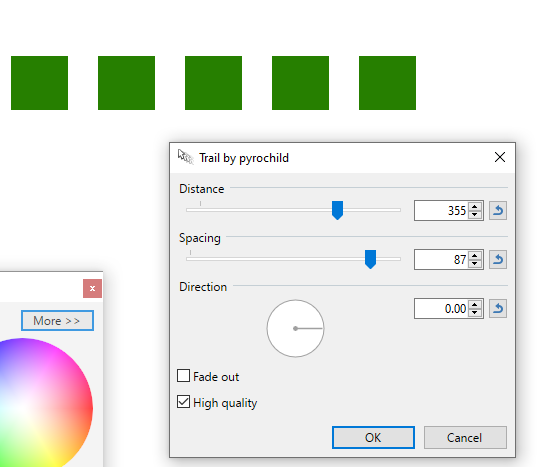

Pixey Posted October 3 Share Posted October 3 3 hours ago, RickGotTaken said: I would like to do something similar to this stack exchange thread, but I can't figure out how. If you are referring to the blocks on that site, then: 1. On a new layer make one block first. 2. Then go to the plugin Trail. Quote How I made Jennifer & Halle in Paint.net My Gallery | My Deviant Art "Rescuing one animal may not change the world, but for that animal their world is changed forever!" anon. Link to comment Share on other sites More sharing options...
RickGotTaken Posted October 3 Author Share Posted October 3 (edited) 28 minutes ago, Pixey said: If you are referring to the blocks on that site, then: 1. On a new layer make one block first. 2. Then go to the plugin Trail. This just gives the boxes a trail, it doesn't seem to be doing the same thing as the image attached to the original stack exchange post. To clear up any confusion, I would like to replicate the results found in the 1st/3rd example. Edit: I do not want to align just simple cubes, I would also like to align objects with slight detail. Edited October 3 by RickGotTaken Clearing confusion. Quote Link to comment Share on other sites More sharing options...

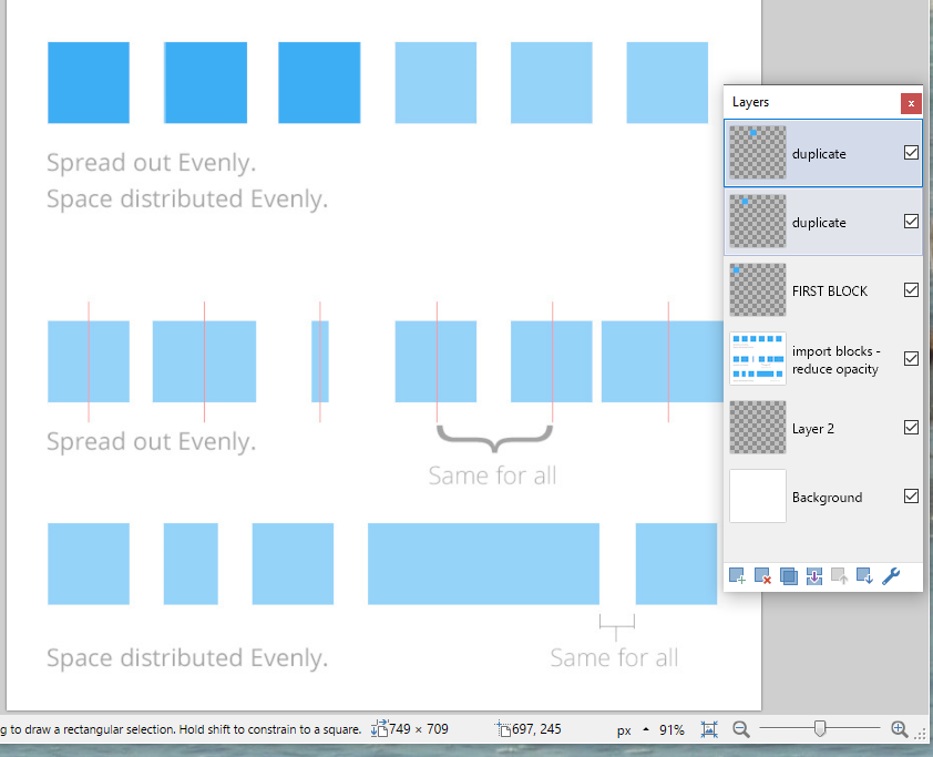

Pixey Posted October 3 Share Posted October 3 18 minutes ago, RickGotTaken said: image attached to the original stack exchange post. Sorry, when I clicked on your link earlier, the site was down and I didn't see the whole image, just the blocks. I think the only way is to create it yourself using the original image and layers: Remember to 'merge down' a few layers, then duplicate and move accordingly to save time. Quote How I made Jennifer & Halle in Paint.net My Gallery | My Deviant Art "Rescuing one animal may not change the world, but for that animal their world is changed forever!" anon. Link to comment Share on other sites More sharing options...

Pixey Posted October 3 Share Posted October 3 1 hour ago, RickGotTaken said: How would I use more/less objects than the original image though? You could make all the different sized shapes first, and save each shape as a .png into a folder on your computer. Then import them into paint.net and move them around as you like. Are you new to using paint.net? If so, there are many YouTube videos on the basics of using paint Quote How I made Jennifer & Halle in Paint.net My Gallery | My Deviant Art "Rescuing one animal may not change the world, but for that animal their world is changed forever!" anon. Link to comment Share on other sites More sharing options...

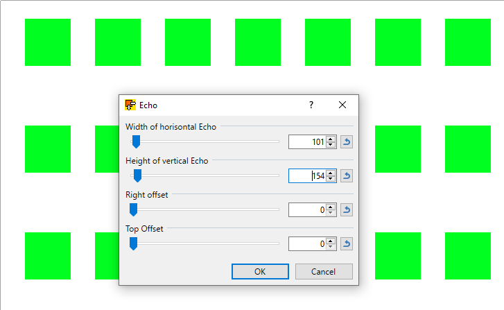

Ego Eram Reputo Posted October 3 Share Posted October 3 A long time ago I created a litle tiling plugin which I didn't officially release. Might be worth a look: https://forums.getpaint.net/topic/14832-stereogram-tools-betas/ What this plugin does is takes the top left corner of the image and tile it across and down the layer. If you want different sized objects, put each on it's own layer. Quote ebook: Mastering Paint.NET | resources: Plugin Index | Stereogram Tut | proud supporter of Codelab plugins: EER's Plugin Pack | Planetoid | StickMan | WhichSymbol+ | Dr Scott's Markup Renderer | CSV Filetype | dwarf horde plugins: Plugin Browser | ShapeMaker Link to comment Share on other sites More sharing options...

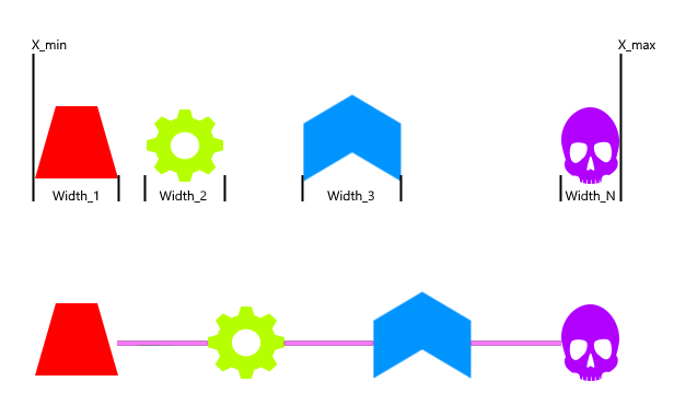

Tactilis Posted October 3 Share Posted October 3 2 hours ago, Pixey said: I thought you wanted to replicate the shapes you show on the posted image. The OP has some objects. He wants them to be distributed so that they have equal space between them. The objects may be all the same width, as shown in the example in the 1st line. Or the objects may have different widths as shown in the 3rd example line. The objects may have some some "slight detail", i.e. they may not be squares or rectangles. Mathematically, he wants to calculate the spacing in pixels between the objects as follows: N = number of objects X_min = X coord of leftmost pixel of leftmost object X_max = X coord of rightmost pixel of rightmost object Spacing = ( (X_max - X_min) - (width_of_object_1 + width_of_object_2 + ... width_of_object_N) ) / (N - 1) And then he wants the objects distributed evenly with the above pixel spacing between them. Quote Link to comment Share on other sites More sharing options...

Pixey Posted October 3 Share Posted October 3 12 minutes ago, Tactilis said: And then he wants the objects distributed evenly with the above pixel spacing between them. Yep, I thought that was what he meant, thus saying that he make the images first, then distribute them accordingly. But, as @BoltBait says, there's too much math involved in doing this manually 😲 Quote How I made Jennifer & Halle in Paint.net My Gallery | My Deviant Art "Rescuing one animal may not change the world, but for that animal their world is changed forever!" anon. Link to comment Share on other sites More sharing options...
RickGotTaken Posted October 3 Author Share Posted October 3 55 minutes ago, Pixey said: When you say 1/3rd example, this is confusing. I meant that I want to replicate either the 1st example, or the 3rd. I only want to do this with one object, so I'm assuming it would work similar to the 1st example. 21 minutes ago, Tactilis said: The OP has some objects. He wants them to be distributed so that they have equal space between them. The objects may be all the same width, as shown in the example in the 1st line. Or the objects may have different widths as shown in the 3rd example line. The objects may have some some "slight detail", i.e. they may not be squares or rectangles. Mathematically, he wants to calculate the spacing in pixels between the objects as follows: N = number of objects X_min = X coord of leftmost pixel of leftmost object X_max = X coord of rightmost pixel of rightmost object Spacing = ( (x_max - x_min) - (width_of_object_1 + width_of_object_2 + ... width_of_object_N) ) / (N - 1) And then he wants the objects distributed evenly with the above pixel spacing between them. This is correct. 14 minutes ago, BoltBait said: Working with Objects really isn't what Paint.NET does best. Perhaps another tool would be better for what you want to do. Have you tried Inkscape or CorelDRAW? No, I haven't. I'd rather stick to paint.net if possible since I am unfamiliar with the layout of any other art programs. Quote Link to comment Share on other sites More sharing options...
Tactilis Posted October 3 Share Posted October 3 1 hour ago, RickGotTaken said: I'd rather stick to paint.net if possible In which as you will need to do the spacing calculation as I indicated above and distribute the objects manually. 1. Find (X_max - X_min) by, for example, doing a Rectangle Select and adjusting the left and right sides of the selection to touch the leftmost and rightmost edges of the 1st and Nth object. The bounding rectangle width is displayed in the status bar. 2. You can measure the width of each object in turn by doing a Magic Wand selection of it (or using the Rectangle Select technique as above) and again reading the bounding rectangle width in the status bar. 3. Once you have calculated the required spacing, you could draw a horizontal line of that length on a new layer and use this as a measuring 'stick' to space out each object. Move the stick immediately right of object 1 Move object 2 to the other end of the stick. Move the stick immediately right of object 2 Move object 3 to the other end of the stick. etc It may seem a bit tedious doing this manually but it's a viable approach if you don't have too many images to process. 1 Quote Link to comment Share on other sites More sharing options...
