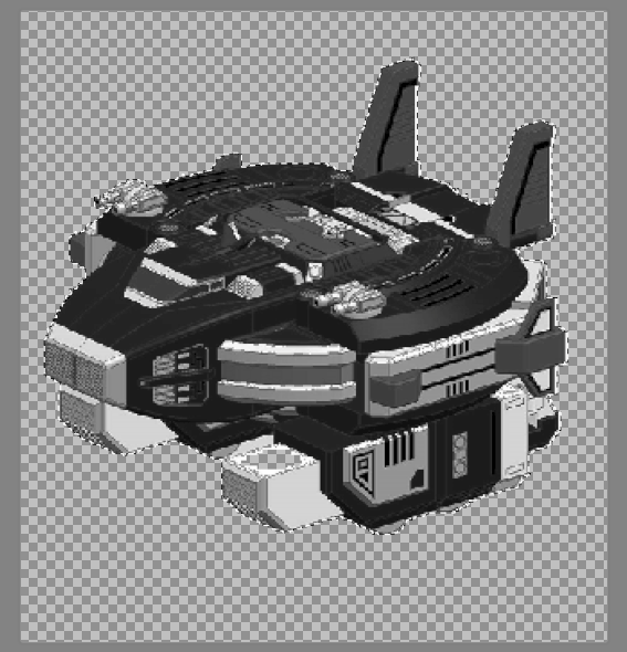

dbzang Posted September 27 Author Share Posted September 27 I want to make this picture here, solid black...so the pic to be solid black.... Quote Link to comment Share on other sites More sharing options...

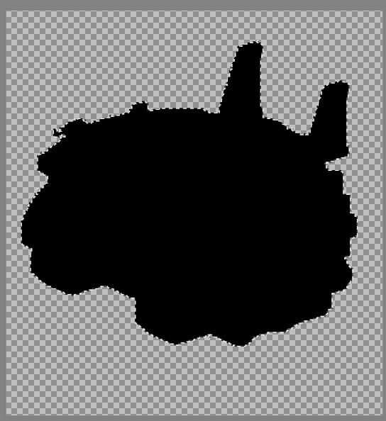

Tactilis Posted September 27 Share Posted September 27 1 hour ago, dbzang said: I want to make this picture, solid black...so the pic to be solid black.... 1. In the Colors window set the Primary colour to black (click on the black/white icon ) 2. Press Shift+S to activate the Magic Wand tool 3. Click on a transparent pixel in your picture. This will select all of the transparent area as shown below. 4. Press Ctrl+I to do Edit > Invert Selection. This will select the vehicle. 5. Press Backspace to do Edit > Fill Selection 6. Press Ctrl+D (or Esc) to do Edit > Deselect 1 Quote Link to comment Share on other sites More sharing options...

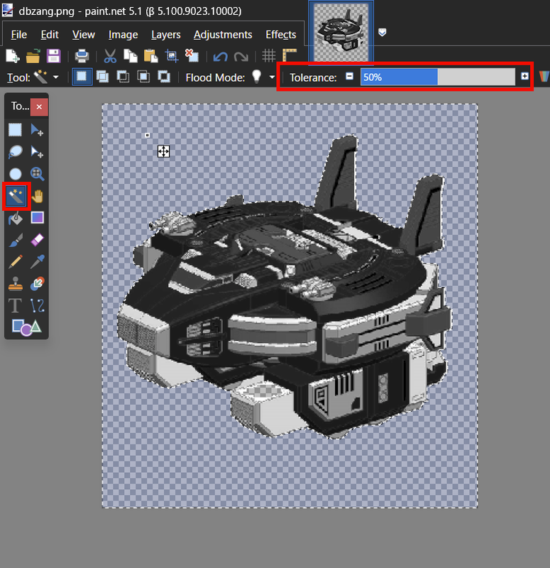

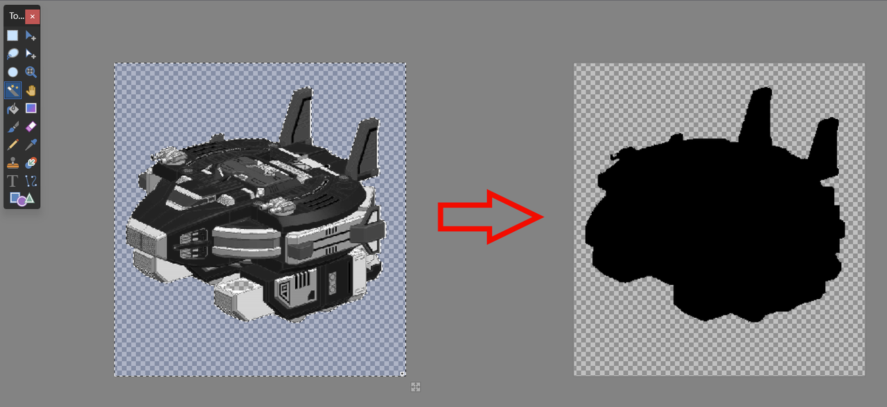

Tactilis Posted September 28 Share Posted September 28 1 hour ago, dbzang said: but I DONT UNDERSTAND! Okay - (but please don't SHOUT!) 1 hour ago, dbzang said: Im trying to make it work...but its not In the screenshot below I've highlighted in red the Magic Wand tool and the Tolerance control in the toolbar. If we now follow the previous instructions: Step 3: Using the Magic Wand I have clicked on a transparent pixel. Tolerance is set to 50%. You can see from the dotted selection outline that only the transparent area is selected. Step 4: Here we Invert the selection. The dotted selection outline is now around the vehicle only. Step 5: Here we Fill the selected area with the Primary colour (which we set in Step 1 to black). Notice that the selection still exists. Step 6: Deselect the selection. If this is not understandable, or it still is not working for you, then please show us screenshots of exactly what differs from the above. Quote Link to comment Share on other sites More sharing options...
