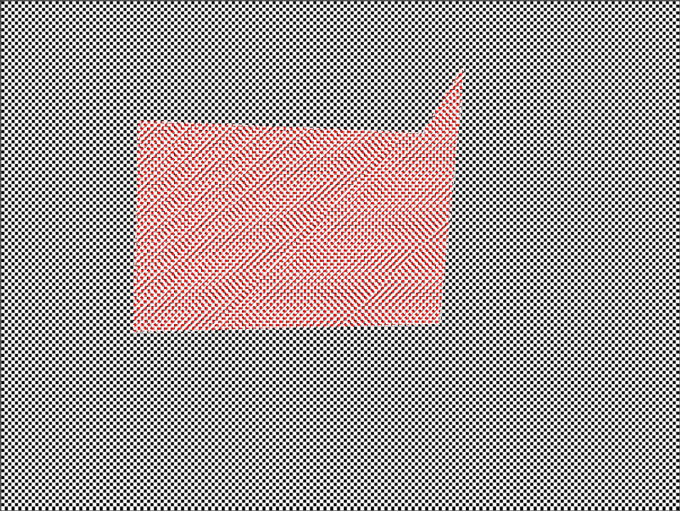

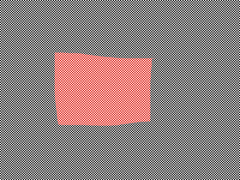

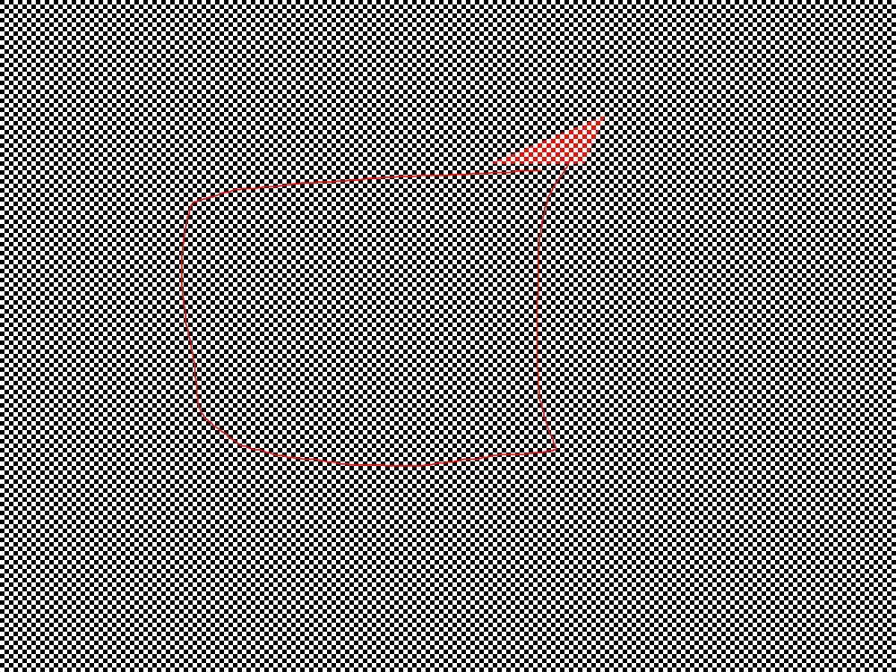

Tactilis Posted August 8 Share Posted August 8 3 hours ago, _koh_ said: 1. paint the image with black and white checker board. 2. select all black pixels with magic wand tool, flood mode = global. 3. select part of them with lasso select tool, selection mode = intersect. By doing this, lasso select tool being very slow and doesn't work as intended. Confirmed that 5.1 beta is much slower at step 3 than 5.0.13 to the extent that the lasso select does not capture all the mouse movements, so the final selection shape is incorrect. For reference, in the tests below I started with a 1000 x 750 canvas and used Boltbait's Grid/Checkerboard plugin to create a 5 x 5 pixel black&white checkerboard. Then at step 3, I moved the mouse quickly to select a (very approximate) 400 x 300 pixel square. Here's the 5.0.13 lasso selection, which I've coloured red to make it easier to see: Here's the 5.1 8986 Beta lasso selection. The red line represents my approx mouse movement. NB It's possible that in the above test, I overshot with the mouse to the upper corner of the triangle - but then I'd have expected the selection to be as shown below, which I created using 5.1 8986 Beta by moving the mouse very slowly: Link to comment Share on other sites More sharing options...
_koh_ Posted August 8 Share Posted August 8 Yeah, "the lasso select does not capture all the mouse movements". Couldn't put this in English. haha. 1 Link to comment Share on other sites More sharing options...
