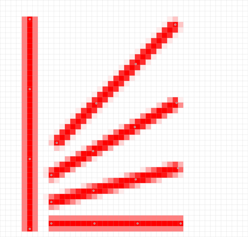

Below I held down Shift while drawing lines to constrain them to 0° / 15° / 30° / 45° / 90° and have shown the position of the control nubs.
It would not be possible to draw lines at exactly 15° and 30° if their end points had to be centred on a pixel.
Note that it is possible for 45° though, as you can see above.
Similarly, the mid control nubs cannot be constrained to being centred on a pixel, otherwise the lines would have a small kinks in them rather than being mathematically straight.
As you have observed, when you initially draw a straight line that is not angle-constrained (i.e. when not using Shift), paint.net does snap the end point to the centre of a pixel*. But for the reason described above, the mid control nubs necessarily cannot be pixel centred. It then follows that when you adjust the mid control nubs to create a curve, it should be possible to move them freely, rather than have them snap to the centre of pixels as you desire.
