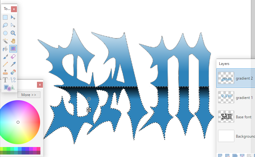

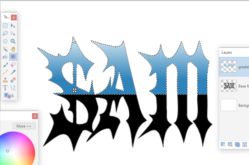

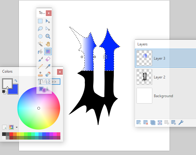

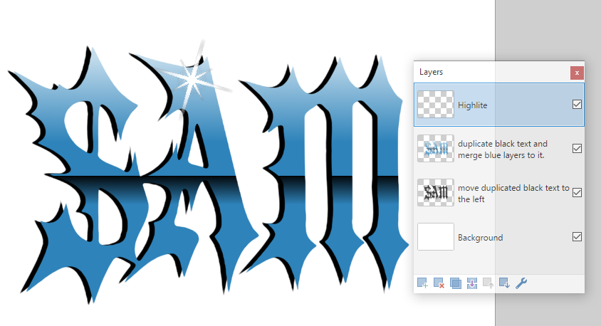

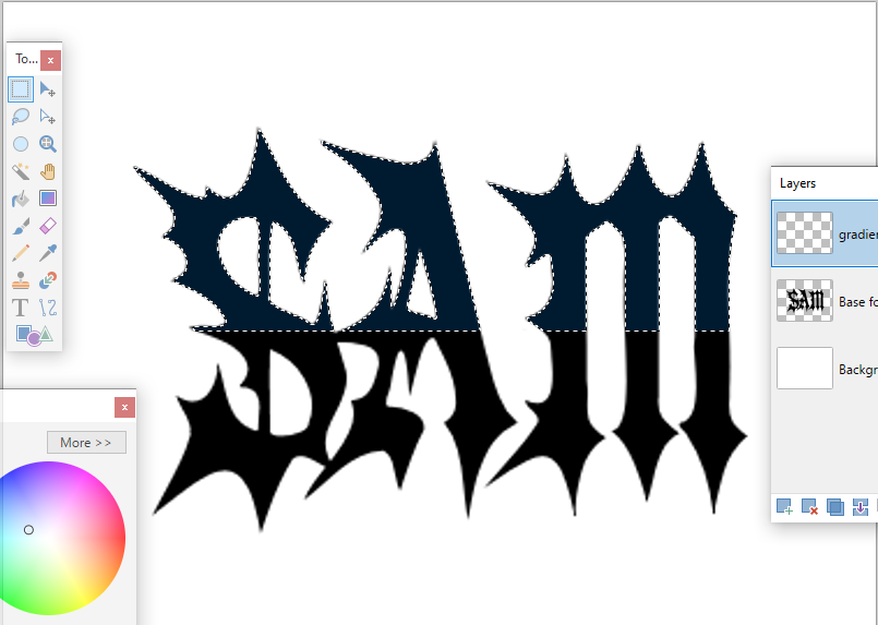

Solution Pixey Posted October 11, 2023 Solution Posted October 11, 2023 Hello @imgspace1484 here is a simple tutorial which may help you. I guess for your purpose, only use the bevel a bit less on your font: https://www.youtube.com/watch?v=WrKTUDICwik Also, here is a quick idea of how to use the gradient only: 2. 3. 4. 1 Quote How I made Jennifer & Halle in Paint.net My Gallery | My Deviant Art "Rescuing one animal may not change the world, but for that animal their world is changed forever!" anon.
