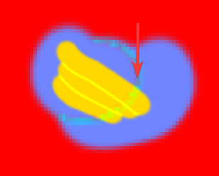

enteristic Posted June 2 Share Posted June 2 Does someone know how to fix this? Quote Link to comment Share on other sites More sharing options...
Pixey Posted June 2 Share Posted June 2 2 hours ago, enteristic said: Does someone know how to fix this? If your starting image has a change of color, or shadow > The Recoloring Tool respects shading when changing the color. As you will see, the blue on the top of the banana is lighter, because of the shading on the image: 1 Quote How I made Jennifer & Halle in Paint.net My Gallery | My Deviant Art "Rescuing one animal may not change the world, but for that animal their world is changed forever!" anon. Link to comment Share on other sites More sharing options...
Disk4mat Posted June 2 Share Posted June 2 @Pixey is correct.... So I was working with the original posted image and had some weird results. Allot of color bleeding. Then I realized I needed to change some settings on the toolbar. Try the following... Hardness 100, Tolerance 10%, Tolerance Mode = Straight, Sample Secondary Color Perhaps Pixey can chime in with her settings? You might play with the Tolerance % based on what you are recoloring. Start low 1 or 2 % and increase as needed. Quote Link to comment Share on other sites More sharing options...
Pixey Posted June 2 Share Posted June 2 I've been playing with this tool a bit more and I'm wondering if it is a bit 'glitchy'? Perhaps someone else can check this please. I got different results with different colors. With blue I got better results, but with orange, not so much. This is the result if you let go of the mouse and 'paint' over, it changes the color. I don't use this tool so much, so am not sure if that it the way it works ? Quote How I made Jennifer & Halle in Paint.net My Gallery | My Deviant Art "Rescuing one animal may not change the world, but for that animal their world is changed forever!" anon. Link to comment Share on other sites More sharing options...

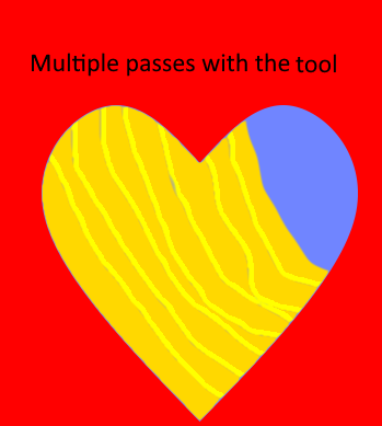

Ego Eram Reputo Posted June 4 Share Posted June 4 I usually use the tool with Sampling Secondary. True I have to set the Secondary color, but this is less prone to (my own) error than sampling from the active layer. 13 hours ago, Pixey said: If @toe_head2001 and, or, @Ego Eram Reputo could check on this tool please 🙂. Tried it just now. Worked as expected using the default settings on a simple image. I'm wondering if the OP is finding a border created when multiple recoloring operations are performed. Below there are three yellow stripes. Created one at a time. See the bright yellow border between them? Pro-Tip: don't let go of the mouse button until the entire area is recolored (for this reason I usually use a very large brush). 1 Quote ebook: Mastering Paint.NET | resources: Plugin Index | Stereogram Tut | proud supporter of Codelab plugins: EER's Plugin Pack | Planetoid | StickMan | WhichSymbol+ | Dr Scott's Markup Renderer | CSV Filetype | dwarf horde plugins: Plugin Browser | ShapeMaker Link to comment Share on other sites More sharing options...
Pixey Posted June 4 Share Posted June 4 Thank you @Ego Eram Reputo Yes, I think the OP did not keep the mouse button pressed down. Thank you for clarifying that tip/point. Quote How I made Jennifer & Halle in Paint.net My Gallery | My Deviant Art "Rescuing one animal may not change the world, but for that animal their world is changed forever!" anon. Link to comment Share on other sites More sharing options...

Pixey Posted June 4 Share Posted June 4 56 minutes ago, Disk4mat said: What I cant figure are the green pixels. That's being caused by multiple passes of the tool. Hence the importance of keeping it down to one pass only. With constant pressure and one pass over the color: 2 Quote How I made Jennifer & Halle in Paint.net My Gallery | My Deviant Art "Rescuing one animal may not change the world, but for that animal their world is changed forever!" anon. Link to comment Share on other sites More sharing options...

Ego Eram Reputo Posted June 5 Share Posted June 5 13 hours ago, Disk4mat said: seems to have been a tolerance setting Not quite. It's the recoloring of a previously recolored region. Hence it only happens at the border. I suspect he OP has recolored top+left region then released the mouse and recolored the bottom+right. The lighter pixels are the places where a double recoloring has occured, i.e. the intersection of the two operations. Quote ebook: Mastering Paint.NET | resources: Plugin Index | Stereogram Tut | proud supporter of Codelab plugins: EER's Plugin Pack | Planetoid | StickMan | WhichSymbol+ | Dr Scott's Markup Renderer | CSV Filetype | dwarf horde plugins: Plugin Browser | ShapeMaker Link to comment Share on other sites More sharing options...
