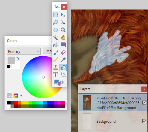

PaintrX33 Posted March 19 Share Posted March 19 Hi all, I've been working on Recoloring characters in Super Smash Bros. Melee for some time now. I'm currently trying to get Ganondorf's Hair Color to change from Orangish to White/gray. Using the Magic Wand Tool always ends up selecting too much, or not enough of certain areas, and it's even harder to NOT select any part of his skin/face. At this point I honestly have no idea how to get the colors changed accurately. Will Link all images below. Thank you! Quote Link to comment Share on other sites More sharing options...

Pixey Posted March 19 Share Posted March 19 1 hour ago, PaintrX33 said: Orangish to White/gray. Welcome to the forum @PaintrX33 You try ysing the Recolor Tool: Quote How I made Jennifer & Halle in Paint.net My Gallery | My Deviant Art "Rescuing one animal may not change the world, but for that animal their world is changed forever!" anon. Link to comment Share on other sites More sharing options...
PaintrX33 Posted March 19 Author Share Posted March 19 (edited) I have tried the tolerance, for these images it's still quite difficult. I totally forgot about the Lasso Tool, haven't used it before honestly. Heck yeah! Melee is awesome, been playing it 20 years! So I tried selecting the area, and used Lasso to help, now it became a cluster F after I edited the color...with my terrible selection skills lmao Edited March 19 by PaintrX33 Quote Link to comment Share on other sites More sharing options...
PaintrX33 Posted March 19 Author Share Posted March 19 (edited) @Pixey Yes, I've tried it, but as you can see in your example, that seems to just put a white overlay on top of the orange..I'd need the image to be selected and made Black and White first.. Edited March 19 by PaintrX33 Quote Link to comment Share on other sites More sharing options...
PaintrX33 Posted March 19 Author Share Posted March 19 It's looking like the only way to do it right is to select around the image just perfectly with lasso + magic wand, black + white the hair, then adjust levels. I'm terrribbblee at the selection part though.. Quote Link to comment Share on other sites More sharing options...
MJW Posted March 19 Share Posted March 19 I suggest you try BoltBait's Hue/Saturation+, which will let you conditionally modify color. Try setting the From Hue to 315 and the To Hue to 33. Then set the Saturation Adjustment to -100. (That's what worked for the small region you showed. You may need to play around with the settings to get the best result.) You may want to first loosely select the region around the hair to prevent other features from being recolored. EDIT: A useful trick is to put the recolored image in a layer above the the original image, then use a soft eraser to remove or reduce unwanted changes by letting the original image show through. Remember that reducing the Primary Color's alpha can be used to reduce the erasing strength, giving you more subtle control. EDIT 2: I'll also add that a variation of the two-layer idea can be useful for recoloring. For the current example, recolor the whole image to gray by making it black and while. Put it in a layer below the original image. Now use the eraser to erase the hair in the original layer, letting the gray hair show through. I find it much easier to control the results when erasing then when using selections. Quote Link to comment Share on other sites More sharing options...
Ego Eram Reputo Posted March 20 Share Posted March 20 I selected the face color with multiple selections (chain them together by holding down the Ctrl Key). Each selection added can have it's own Tolerance - so fine tune each new selection using Tolerance before adding the next one. Each time you want the highest tolerance that does not include any hair (this is called Selection Building). When I had the entire face selected, I added a new layer and filled the selection with a contrasting color to act as a mask. Use either BoltBait's Feather Object or AA's Assistant to soften the mask edge. Select the unmasked region of the mask layer. Return to the Image layer & run Hue/Saturation to apply new highlights to the hair. This was a rather rushed attempt. With care you should be able to make the edges better Quote ebook: Mastering Paint.NET | resources: Plugin Index | Stereogram Tut | proud supporter of Codelab plugins: EER's Plugin Pack | Planetoid | StickMan | WhichSymbol+ | Dr Scott's Markup Renderer | CSV Filetype | dwarf horde plugins: Plugin Browser | ShapeMaker Link to comment Share on other sites More sharing options...
