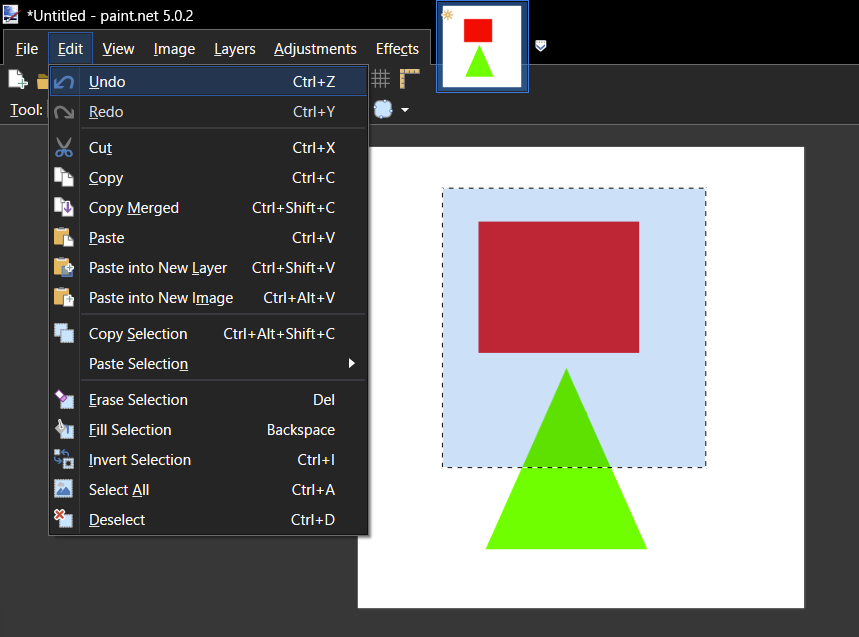

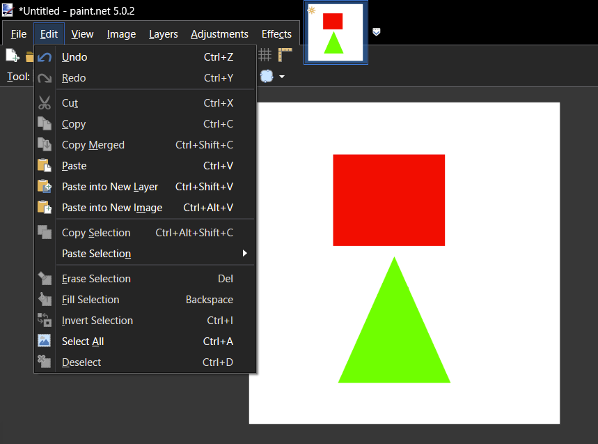

Tactilis Posted March 18 Share Posted March 18 When a selection exists, then the menu items Edit | Copy and Edit | Copy Merged are active as expected: When there is no selection Edit | Copy and Edit | Copy Merged are greyed out: These items should not be greyed out as it is, quite rightly, still possible to perform their functions using the shortcuts Ctrl+C and Ctrl+Shift+C. Because they are greyed out it is not possible to invoke them using Alt+EC and Alt+EM. @Rick Brewster Would it be possible to correct this for 5.0.3 please? Additionally, the Edit Menu page of the Documentation needs a couple of updates to accurately reflect the operation of the commands: 1 Quote Link to comment Share on other sites More sharing options...
Solution Rick Brewster Posted March 19 Solution Share Posted March 19 Oh funny, how did I not notice this I completely forgot that Ctrl+C / Ctrl+Shift+C works even when there's no selection. I'll take a look. Quote The Paint.NET Blog: https://blog.getpaint.net/ Donations are always appreciated! https://www.getpaint.net/donate.html Link to comment Share on other sites More sharing options...

Rick Brewster Posted March 24 Share Posted March 24 Try out the 5.0.3 beta, which has this fixed: 1 Quote The Paint.NET Blog: https://blog.getpaint.net/ Donations are always appreciated! https://www.getpaint.net/donate.html Link to comment Share on other sites More sharing options...
Tactilis Posted March 24 Author Share Posted March 24 Confirmed fixed. Thank you. 1 Quote Link to comment Share on other sites More sharing options...
