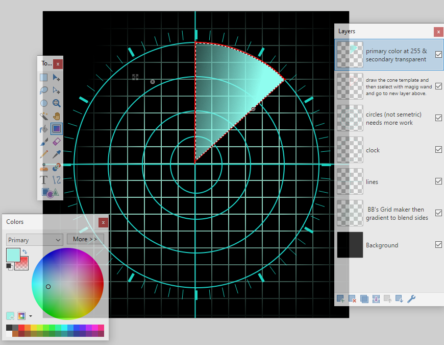

semar Posted March 8 Share Posted March 8 (edited) Hi all, I'm new to Paint.Net, and I would like to paint the beam of a radar with a circular gradient. To better understand what I mean, here is what I would like to achieve: radar I would like to build two images. The first ist the grid (I didn't try yet but I think it is not soooo complicated). The second image is the beam, which seems a conic gradient (from green to black) which spreads on an angle, say, of 30 degrees. In my application, the beam image should rotate above the grid image, in order to achieve the radar-beam effect (both images will be "blended" togheter, so that the beam image does not mask the grid image below). I can indeed obtain a similar beam, but the conic gradient makes the gradient from, say, green to black from 0 to 180 degrees. What I need, however, is to limit the gradient only to, say, 0 to 30 degrees. I've tried also the circular gradient, and also played with the filling-type, but I can't achieve what I want. So the question, is there any setting in order to apply a conic gradient only to a certain degrees range ? Thanks in advance and have a nice day, Sergio Edited March 8 by semar Quote Link to comment Share on other sites More sharing options...

Pixey Posted March 8 Share Posted March 8 Hello @semar and welcome to the forum Here are a few 'idea' steps. I used @BoltBait's Grid maker, which is found in his pack. Once you make the gradient, as per the template, you can then go back and select a bigger circle and add some more gradient. 2 Quote How I made Jennifer & Halle in Paint.net My Gallery | My Deviant Art "Rescuing one animal may not change the world, but for that animal their world is changed forever!" anon. Link to comment Share on other sites More sharing options...
semar Posted March 9 Author Share Posted March 9 (edited) First of all, many thanks for your kind and prompt answers @frio and @Pixey ! Dear Pixey, I've followed your - very helpful - step by step guide, and indeed I've succeeded quite everything ! By the way, I've done the simmetric circles using the "target" shape, it makes "regular" circles if you didn't know 🙂 What I still did not achieved are two things: 1. The cone template. I do can make it using the cone shape and rotate it using the ctrl+shift+z = zoom tool, but the "round" part (which is the shorter side of the cone ) is not so precise like your one, that follow the big circle path. My cone has "rounded" vertices, and the curve at the round side - if you get what I mean - does not follow the circular path of the big external circle (the target). I guess it's a matter of drag some point here and there, but the two vertices at the bottom still remain "round". I hope you can understand my "english" - sorry ! 2. the gradient part. I still have to understand what does frio mean - thank you again frio by the way ! - with the "Levels adjustment (control-L) to compress the range". You see, I'm a beginner with Paint.net.😉 And also I have to get your last step, "primary color at 255 & secundary transparent". I understand this sentence (horray ! 😉 ) but I don't know how do you use the gradient tool here. Same for "Once you make the gradient, as per the template, you can then go back and select a bigger circle and add some more gradient." Which makes sense for all of you, but me 😉 - I have to work on it ! Anyway your hints have helped me a lot ! Now with a fresh mind I'll try again to get that "Gradient with compressed range". I'll keep you informed 😉 By the way, who makes all these cool plugins ? And which are the steps and the programming-language to use in order to program such a plugin ? I'm just curious 🙂 Have a nice day and thanks again for your help, Sergio P.S.: My achievement so far: Edited March 9 by semar Quote Link to comment Share on other sites More sharing options...
semar Posted March 9 Author Share Posted March 9 Getting there.. but I don't really know how I did that ! 😉 Still have to work on the curved vertices, and the base of the cone, which does not follow the curve of the target.. Quote Link to comment Share on other sites More sharing options...
Lemonade Posted March 9 Share Posted March 9 Hey @semar, I would go with circle and triangle to create a cone, where circle is the same size as your outer (biggest) green circle. Then add a triangle and where both shapes intersect, use lasso tool to delete that area. Attached an example. Quote Link to comment Share on other sites More sharing options...
semar Posted March 9 Author Share Posted March 9 Cheers Lemonade, that is indeed a good idea ! Now I'll investigate on how to draw a circle around another one, and how to use effectively the lasso.. Thanks a lot ! Have a nice day, Sergio Quote Link to comment Share on other sites More sharing options...
semar Posted March 9 Author Share Posted March 9 (edited) While trying, I've discovered that instead of backcolor transparent, I can get better results with backcolor black. And Level adjustments makes wonder 🙂 Perhaps there's a better way as Pixey suggested, but right now I don't know which mouse-moves have to be done while using the conic gradient.. I had to change the layer orders though.. now the "gradient" layer is the second one from below. Perhaps using transparent instead of black would be far more better, however I don't get the same behaviour using the Level adjustment tool. Oh my. This is the result so far, which is not bad for a newby 😉 Edited March 9 by semar Quote Link to comment Share on other sites More sharing options...
Solution Pixey Posted March 9 Solution Share Posted March 9 I hope this video will help you @semar in how to use the Gradient Tool 2 1 Quote How I made Jennifer & Halle in Paint.net My Gallery | My Deviant Art "Rescuing one animal may not change the world, but for that animal their world is changed forever!" anon. Link to comment Share on other sites More sharing options...
