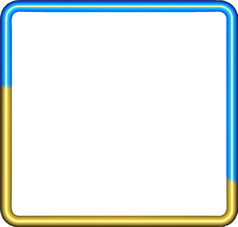

Ego Eram Reputo Posted January 15, 2023 Share Posted January 15, 2023 Use the color picker tool + Right click to set the Secondary color to a mid-yellow from the image. Choose the replacement color as the Primary color. Activate the Recoloring tool In the toolbar, set the Sampling to the Secondary color. Increase the size of the brush to something like 100 "Paint" the new shade over the old. Here I've replaced the yellow with blue Quote ebook: Mastering Paint.NET | resources: Plugin Index | Stereogram Tut | proud supporter of Codelab plugins: EER's Plugin Pack | Planetoid | StickMan | WhichSymbol+ | Dr Scott's Markup Renderer | CSV Filetype | dwarf horde plugins: Plugin Browser | ShapeMaker Link to comment Share on other sites More sharing options...

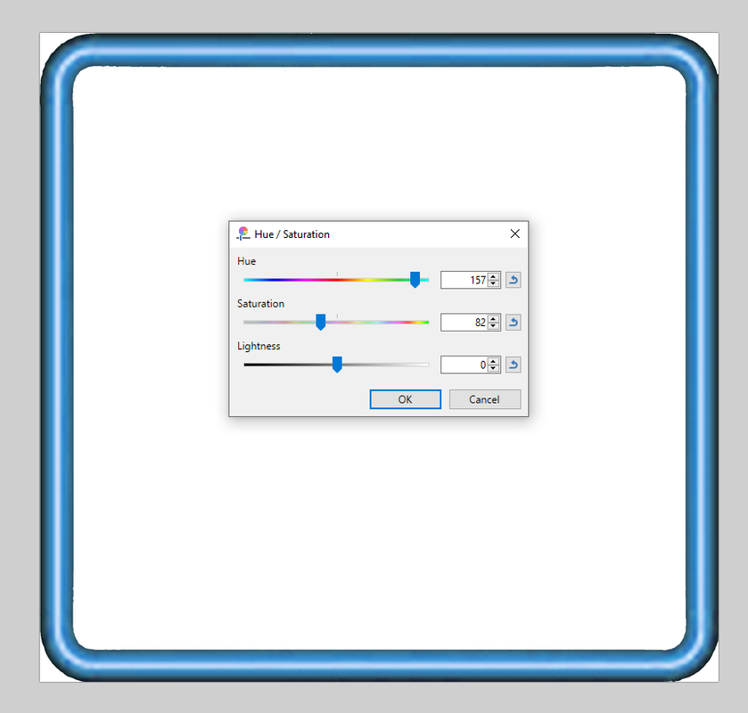

Solution Ego Eram Reputo Posted January 15, 2023 Solution Share Posted January 15, 2023 PS I had excellent success with Hue/Saturation when I tried. If you found it too extreme, try lowering the Saturation and/or Lightness Pro-Tip: Use the keyboard arrows (up & Down) to make small adjustments to the numeric values 1 Quote ebook: Mastering Paint.NET | resources: Plugin Index | Stereogram Tut | proud supporter of Codelab plugins: EER's Plugin Pack | Planetoid | StickMan | WhichSymbol+ | Dr Scott's Markup Renderer | CSV Filetype | dwarf horde plugins: Plugin Browser | ShapeMaker Link to comment Share on other sites More sharing options...
Patgom145 Posted January 15, 2023 Author Share Posted January 15, 2023 That's perfect. I had never seen this small recoloring tool. Many many thanks, pg Quote Link to comment Share on other sites More sharing options...
Patgom145 Posted January 15, 2023 Author Share Posted January 15, 2023 That's perfect. I had never seen this small recoloring tool. With the Hue/Saturation adjustment tool you have dirty blurry things in the corners that you don't have with your first method. Many many thanks, pg Quote Link to comment Share on other sites More sharing options...
