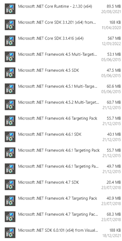

toe_head2001 Posted December 21, 2021 Share Posted December 21, 2021 The try-convert utility can upgrade your project to .NET 5 or .NET 6; If you have more than more SDK installed, it will prompt you to choose one. 1 Quote My Gallery | My Plugin Pack Layman's Guide to CodeLab Link to comment Share on other sites More sharing options...
AndrewDavid Posted December 21, 2021 Share Posted December 21, 2021 @toe_head2001 You have something else to make try-convert show Net 6.0 This is what I have installed; However when I run Try-Convert the highest choice I see is No need to show all the choices, They are listed newest to oldest. I find only works in all cases. Perhaps its the utility you use to decompile the DLL (I use JetBrainsDotPeek 2021.3.1 Quote Link to comment Share on other sites More sharing options...
