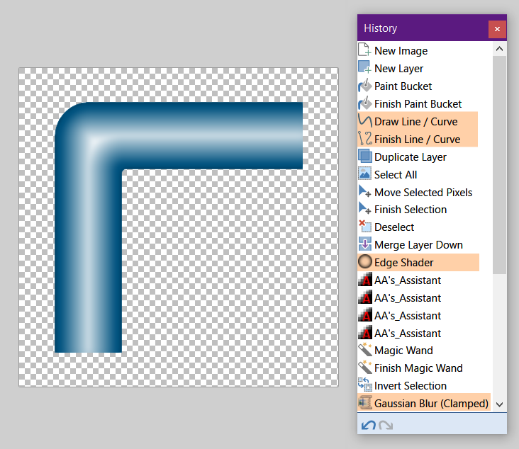

lynxster4 Posted July 17, 2021 Share Posted July 17, 2021 My thoughts exactly @MJW and @Red ochre! 😄 @Hodor, maybe this will be acceptable? 1 1 Quote My Art Gallery | My Shape Packs | ShapeMaker Mini Tut | Air Bubble Stained Glass Chrome Text with Reflections | Porcelain Text w/ Variegated Coloring | Realistic Knit PatternOpalescent Stained Glass | Frosted Snowman Cookie | Leather Texture | Plastic Text | Silk Embroidery Visit my Personal Website "Never, ever lose your sense of humor - you'll live longer" Link to comment Share on other sites More sharing options...

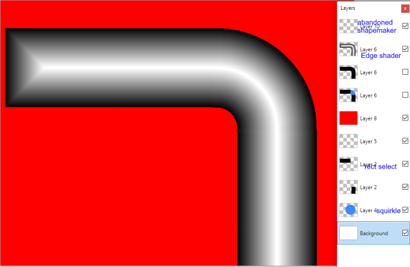

Red ochre Posted July 17, 2021 Share Posted July 17, 2021 @lynxster4 - I did experiment but was too lazy to upload an example 🙄+ got distracted trying to make the pipe shape in Shapemaker and gave up!🤪 I think a re-useable shape might benefit @Hodor but arcs of circles joined to rectangles are trickier than I remembered!😄 1 Quote Red ochre Plugin pack.............. Diabolical Drawings ................Real Paintings Link to comment Share on other sites More sharing options...
lynxster4 Posted July 17, 2021 Share Posted July 17, 2021 1 minute ago, Red ochre said: think a re-useable shape might benefit @Hodor I agree. I simply used the Line/Curve Tool at 100 pixels, one end rounded and the other flat for my example. It all depends on how 'fancy' he intends on getting with the pipes. 😁 1 Quote My Art Gallery | My Shape Packs | ShapeMaker Mini Tut | Air Bubble Stained Glass Chrome Text with Reflections | Porcelain Text w/ Variegated Coloring | Realistic Knit PatternOpalescent Stained Glass | Frosted Snowman Cookie | Leather Texture | Plastic Text | Silk Embroidery Visit my Personal Website "Never, ever lose your sense of humor - you'll live longer" Link to comment Share on other sites More sharing options...
Red ochre Posted July 17, 2021 Share Posted July 17, 2021 😉 1 Quote Red ochre Plugin pack.............. Diabolical Drawings ................Real Paintings Link to comment Share on other sites More sharing options...

Hodor Posted July 17, 2021 Author Share Posted July 17, 2021 nice, so many solutions! @lynxster4 - @ardneh solution was also acceptable, but yes yours looks better for my case hehe. I'll try the edge shader! @Red ochre - looks a bit complex (so many layers and shapes) xd also, why do you have that "squirkle" / blue circle layer? @Ego Eram Reputo - I liked the fitting idea, nice! Also cool plugin, but looks like it doesn't have a zip so I'll do without. Still a great idea! And thanks everyone for the help Quote Link to comment Share on other sites More sharing options...
Red ochre Posted July 17, 2021 Share Posted July 17, 2021 4 hours ago, Hodor said: why do you have that "squirkle" / blue circle layer? That was the easiest way to create a radiused inner and outer curve to connect the two rectangles. Quote Red ochre Plugin pack.............. Diabolical Drawings ................Real Paintings Link to comment Share on other sites More sharing options...
