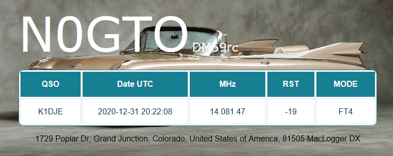

Thanks for the reply, Rep! The basic idea is to have a background picture on a roughly postcard-sized image. The top layer would be multiple rectangular-shaped text fields that could be filled in from "some type" of external source, such as a .txt, .csv, or similar file. So a variable named "A1" might refer to the first segment of a line in a .csv file, "A2" might refer to the second segment, and so on.
The purpose of this is that I am a ham radio operator and this would generate a "QSL" card, which, when printed out or emailed, is written confirmation of a contact made on-air with another ham.

Can you show me an example of what you're trying to produce?
This isn't my design. This is what has prompted me to create my own. The white fields at the very bottom labelled QSO, DATE UTC, MHZ, RST, and MODE are the fields I wanted to try to fill in with variables. All other items, such as address, are one-time entries and won't change.

Looks like the plugin is not rendering the window correctly. An update is being worked on. In the meantime steps 3 to 6 are a workaround....
  1. Paste the code below into the plugin code window.
  2. Resize the plugin window to accomodate the image.
  3. Press Ctrl + Alt + PrtScn
  4. Cancel the plugin.
  5. Ctrl + V
  6. Crop as required.
<!DOCTYPE html>
<head>
<meta http-equiv="X-UA-Compatible" content="IE=Edge,chrome=1" />

<h1>N0GTO</h1>
<h2>DM59rc</h2>
<table class="responstable">
  <tr>
    <th>QSO</th>
    <th>Date UTC</th>
    <th>MHz</th>
    <th>RST</th>
    <th>MODE</th>
  </tr>
  <tr>
    <td>K1DJE</td>
    <td>2020-12-31 20:22:08</td>
    <td>14.081.47</td>
    <td>-19</td>
    <td>FT4</td>
  </tr>
 </table>
<p>1729 Poplar Dr, Grand Junction, Colorado, United States of America, 81505  MacLogger DX</p>
</body>
</html>
To edit the details, change the text and resave.
Again, that is NOT my design. That is an image I copied & pasted from an email I received, not something I created with Paint.net. I have not loaded any plugins in the program, and the only thing Paint.net had to do with this image is to crop the size for posting here. This was only posted to show a sample of what I wanted to accomplish.
BTW - I prefer the GTO, but old Caddy drop-tops are okay, too!
Doc
14 hours ago, Reptillian said:
I'm fairly impressed by what you did there. @Ego Eram Reputo
Thanks Repto. HTML and I work well together 😁 It's a shame the plugin isn't rendering correctly. @toe_head2001 spotted this problem a couple of days ago an we have started work on updating the plugin.
Hey Doc. I grabbed the first online image I liked.
You can change the image fairly easily. In the code there is a URL beside a tag called background-image. Change that URL to any other image you like (it doesn't have to be a car but remember copyright and attribution might still apply). Unsplash.com has a nice range of free images and a few GTO ones .
Feel free to ask if you need more help.
