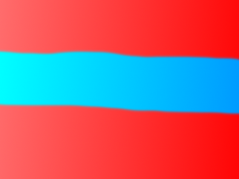

Ego Eram Reputo Posted December 12, 2020 Share Posted December 12, 2020 6 hours ago, 4cidic said: each pixel is a slightly different shade so I can't use the recolor tool. Yes you can (and should). This is exactly what the Recoloring Tool is for. See this image. Red is pale on the left and full saturation on the right. I've recoloried some of it blue using the recoloring tool. Notice how the blue strip is also pale of the left and more heavily saturated on the right? The Recoloring tool did that automatically. I posted a mini tutorial on the Recoloring Tool here: Quote ebook: Mastering Paint.NET | resources: Plugin Index | Stereogram Tut | proud supporter of Codelab plugins: EER's Plugin Pack | Planetoid | StickMan | WhichSymbol+ | Dr Scott's Markup Renderer | CSV Filetype | dwarf horde plugins: Plugin Browser | ShapeMaker Link to comment Share on other sites More sharing options...
