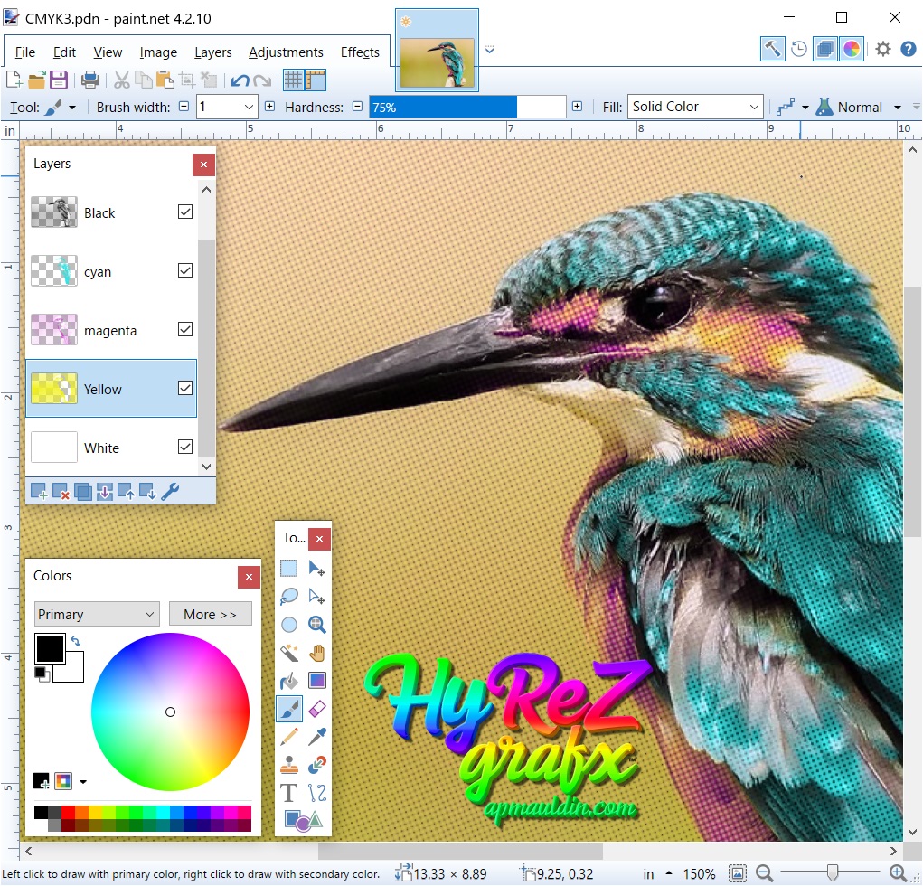

HyReZ Posted March 18, 2020 Share Posted March 18, 2020 (edited) I had suggested earlier in this thread that using the dotted halftone screen effect was the way to go and provided a link to another thread that commented about creating halftones screens for a graphic design. With the use of these two plugins you can produce something very close to the 'comic book' look: Effects > Color Space > RBG to CMYK (RGB2CMYK.dll) by BoltBait Effects > Stylize > Halftone (EdHarvey.Effects.dll) by Ed Harvey You would have to create 4 duplicate layers of your color image and then run the RBG2CMYK plugin on each layer but changing to a different color of the CMYK group each time with the CMY Intensity set to 255. (Remember to give each layer of the RBG2CMYK the correct name; K(black), M(magenta), C(cyan), and Y(yellow)) Next you would run the ED Harvey Halftone plugin on each layer with the dot angle set to 22.5 degrees. Before running the plugin on each layer you will have to set the primary color of the dots for the layer's halftone:( I used a dot size of 4, which is the smallest. For my project I should of used a dot size of ~6) [Layer Order From The Top] Black is R=0, B=0, G=0 Cyan is R=0, B=255, G=255 Magenta is R=255, B=255, G=0 Yellow is R=255, B=0, G=255 Last add a bottom layer that is all white.http://apmauldin.com/Image_Storage/RBG2CMYK.jpg Edited November 23, 2021 by HyReZ to add more nfo / correcting errors 2 Quote Link to comment Share on other sites More sharing options...

HyReZ Posted November 23, 2021 Share Posted November 23, 2021 (edited) On 3/18/2020 at 3:33 AM, HyReZ said: Next you would run the ED Harvey Halftone plugin on each layer with the dot angle set to 22.5 degrees. Before running the plugin on each layer you will have to set the primary color of the dots for the layer's halftone: Before using the halftone plugin you have to make sure that the primary color is corrected in the Colors Box, then run halftone plugin set the correct screen dot angle. Each layer of dots are 22.5 degrees away from the other layers in the layer stack. (These are the screen angles that I prefer) layer 1 = 0 degrees layer 2 = 22.5 degrees layer 3 = 45 degrees layer 4 = 67.5 degrees Here is a link to a useful reference on halftone screen angles:https://en.wikipedia.org/wiki/Screen_angle Edited November 23, 2021 by HyReZ Quote Link to comment Share on other sites More sharing options...
AndrewDavid Posted November 23, 2021 Share Posted November 23, 2021 4 hours ago, savagegreywolf said: How do I set the layer's color? Hello @savagegreywolf Ensure your primary color is set to the color of each layer before you run the halftone plugin. Don't forget to change the angle on each layer. I did, but I still like the outcome. The pic I used is copyrighted, so I shouldn't post it. Quote Link to comment Share on other sites More sharing options...
