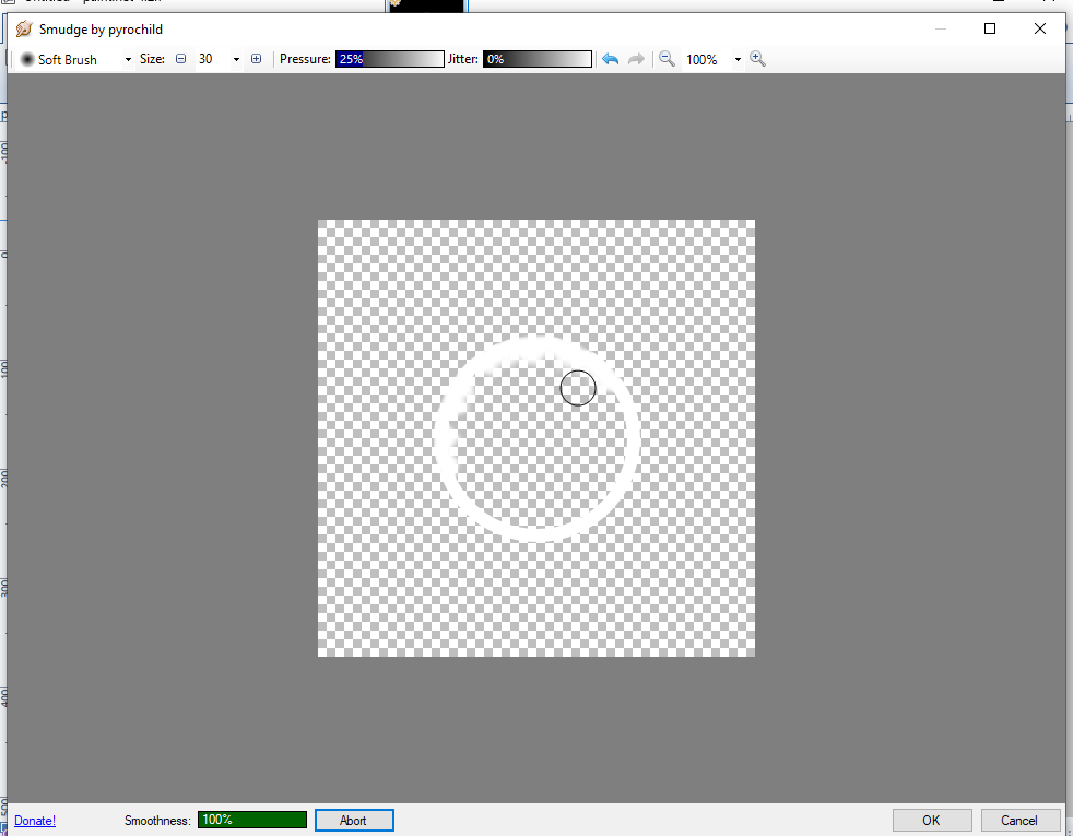

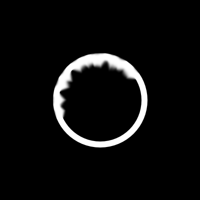

Pixey Posted December 3, 2019 Share Posted December 3, 2019 Hello @Tweve and Welcome to the forum If you want to make the same image as you have posted, you could use the Smudge Tool on the white ring, on it's own layer. To end up like this: I only did 1/2 of it to show you the idea. Quote How I made Jennifer & Halle in Paint.net My Gallery | My Deviant Art "Rescuing one animal may not change the world, but for that animal their world is changed forever!" anon. Link to comment Share on other sites More sharing options...

Tweve Posted December 4, 2019 Author Share Posted December 4, 2019 @Pixey wow so simply yet it works; nice! @LWChris nice solution too! Even though Pixey solution is "simpler", It might be easier for me since I"m not much of an artist. Thank you both! Quote Link to comment Share on other sites More sharing options...

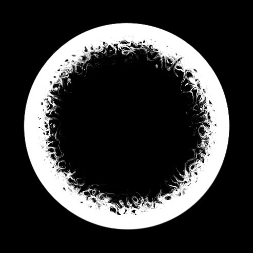

LWChris Posted December 4, 2019 Share Posted December 4, 2019 (edited) Btw, I loved your idea so much, I created an image using the portal I made. I used my "Modify Channels" plugin to "isolate" the portal so I could put in another image inside it. First, you may want to use "Effects > Distort > Dents..." on the "disk" layer to give the outer edge a little "flaming" look. Maybe duplicate that layer and give it a beefy Gaussian Blur with a huge radius for a "halo" effect. Then on the other layer again, apply slight Zoom Blur. Finally, apply "Dents..." with low "Tension" on the two black spike layers for a more "smokey" appearance. Finally, merge all layers onto a black background: Then find my plugin under "Adjustments > Modify Channels...". Using two steps "Alpha = Identity Average" and then "Grayscale = Constant 255", you will isolate the portal. Together with two beautiful stock images from pexels (Road, Countryside), I created this: Edited December 4, 2019 by LWChris 3 1 Quote Link to comment Share on other sites More sharing options...

Tweve Posted December 4, 2019 Author Share Posted December 4, 2019 Oh wow I see I sparked some great ideas in here @LWChris WOW! That is amazing! Also, I can't believe I didn't know about your plugin until now; I needed something like that so many times and had to do it manually, sort of. Amazing! Quote Link to comment Share on other sites More sharing options...
