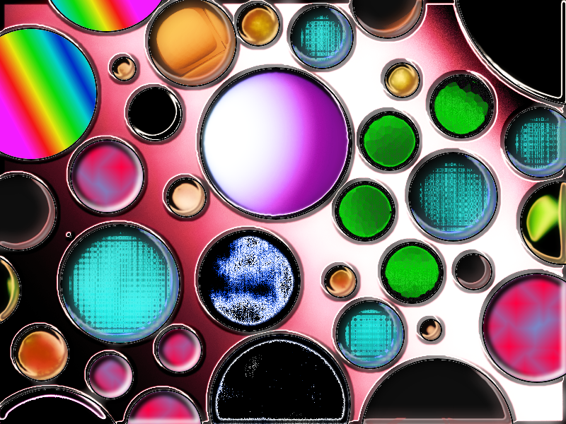

Icegodes Posted December 2, 2019 Share Posted December 2, 2019 (edited) This tutorial will show you how to make this Mosaic I originally planned for it be based off my signature but a power surge made me lose everything, so I went all out with this wall. Download Template.zip Plugins BoltBait Bevel Object Flames Effect Gradient Effect https://forums.getpaint.net/topic/113220-boltbaits-plugin-pack-for-pdn-v41-and-beyond-updated-december-1-2018/ Ed Harvey Glass Blocks Ripple https://forums.getpaint.net/topic/18811-ed-harvey-effects-v-40-2012-02-13/ KrisVDM Drop Shadow Gradient https://forums.getpaint.net/topic/8375-drop-shadow-and-other-effects-krisvdms-plugin-pack-updated-2010-10-26/ pleabo Nightvision https://forums.getpaint.net/topic/20643-night-vision-effect/ pyrochild Film Gradient Bars Gradient Grid Stitches https://forums.getpaint.net/topic/7291-pyrochild-plugins-2017-12-04/ !Save Often! paint can crash from the image Also it might take paint a minute(s) to catch up to changes you make, just be patient it will go through. 1. Magic Wand Base Layer 2. Gradient Color Primary 128,128,128 Secondary 0, 38, 255 Linear Pull from top right to bottom left like so 3. Bevel Object Depth 3 Highlight Black Shadow White Strength 1 4. Curves 5. Soften Portrait Softness 0 Lighting 20 Warmth 20 6. Glow Radius 20 Brightness -41 Contrast 33 7. Deselect back to base layer Magic select this circle then new layer 8. Gradient Colors Primary 0, 255, 246 Secondary 87, 0, 127 Radial Pull from left to right 9. Bevel Selection 10. Curves 11. Glow Radius 20 Brightness 17 Contrast 43 12. Soften Portrait Softness 1 Lighting 20 Warmth 4 13. Deselect back to base layer Magic select these circles then new layer 14.Gradient Bars Primary 203, 0, 255 Secondary Black Gamma-adjusted color blend un-checked Width 1 Spacing 0 Skew 0 Scale 1 Alignment .51 Repetition Repeat 15. Stitch Distance 3 Width 1 Angle -85.24, -3.35 16. Glow 17. Curves 18. Soften Portrait Softness 0 Lighting 20 Warmth 20 19. Bevel Object increase Depth to 6 20. Curves 21. Glow 22. Soften Portrait 23.Deselect back to base layer Magic select these circles then new layer 24. Clouds Primary Color White Secondary Color 0, 38, 198 Scale 491 Roughness .71 25. Glow 26. Duplicate layer 27. On duplicate Layer Twist Amount/Direction 170.14 Size 2 Center .25, .37 Quality 5 28. Film Grain 1.98 Discoloration and Distortion 0 29. Merge the layers 30. Bevel Object Depth 6 Highlight and shadow Black Strength 1 31. Curves 32. Glow Radius 20 Brightness -100 Contrast 100 33. Deselect back to base layer Magic select these circles then new layer 34. Flames Effect Scale 201 Roughness .67 35. Glow Radius 20 Brightness 100 Contrast 10 36. Bevel Object Depth 4 Highlight Black Shadow White Strength 1 37. Curves 38. Glow Radius 1 Brightness 28 Contrast 10 39. Soften Portrait Softness 4 Lighting -20 Warmth 20 40. Deselect back to base layer Magic select these circles then new layer 41. 42. Bevel Object Increase depth to 6 43. Curves 44. Glow 45. Soften Portriat 46. Deselect back to base layer Magic select these circles then new layer 47. Boltbait Gradient From Color 246, 255, 0 To Color 255, 0, 255 Style Radial Side 48. Duplicate Layer 49. On duplicate Layer Twist Amount/Direction 36.50 Size .29 Direction -.64,-.83 50.Merge the layers 51. Curves 52. Psychocolor Phase Shift 1.50 53. Deselect back to base layer Magic select these circles then new layer 54. Kris VDM Gradient 55. Glow Increase Radius to 20 56. Tile Reflection Angle -30.40 Tile Size 95.91 Curvature 8 Quality 5 57. Flames Effect Scale 729 Roughness 0 58. Bevel Object 59. Curves 60. Glow Radius 20 Brightness 25 Contrast 10 61. Deselect back to base layer Magic select these circles then new layer 62. Gradient Bars Primary 0, 255, 242 Secondary Black Width 1 Spacing 0 Skew 0 Scale 1 Alignment 1 Repetition Repeat 63. Glass Blocks Scale 24 Amount 100 Quality 5 64. Drop Shadow X and Y offset 0 Widening Radius 24 Blur Radius 24 Shadow Opacity 255 Shadow Color 0, 33, 255 65. Bevel Object Increase Depth to 8 66. Curves 67. Glow 68. Deselect back to base layer Magic select these circles then new layer 69. Boltbait Gradient Effect From Color 255, 255, 0 To Color Black Style Radial Corner 70. Glow Radius 6 Brightness 56 Contrast 10 71. Crystalize Cell Size 9 Quality 5 72. Nightvision Intensity 50 73. Bevel Object Depth 3 Highlight and Shadow Black Strength 1 74. Curves 75.Curves 76. Film Grain 1.65 Discoloration and Distortion 0 77. Deselect back to base layer Magic select these circles then new layer 78. Julia Fractal Factor 5.85 Zoom 8.09 Angle 0 Quality 5 79. Psychocolor Phase Shift 1.10 80. Ripple Amount 0 Ripples 3.68 Ripple Phase .68 Angle -74.47 Highlight 10 Edge Behavior Reflect Quality 5 81. Bevel Object Depth 6 Highlight Black Shadow White Strength 1 82. Drop Shadow X and Y offset 0 Widening Radius 24 Blur Radius 24 Shadow Opacity 255 Shadow Color 0, 28, 153 83. Curves 84. Glow Radius 20 Brightness 5 Contrast -7 All done! Tip: As I showed once you set your Curves Setting do not change throughout the piece. It can be challenging to work around but really rewarding. Edited December 6, 2019 by Icegodes 3 2 Quote Ice's Gallery Mosaic Wall Tutorial Link to comment Share on other sites More sharing options...

Pixey Posted December 5, 2019 Share Posted December 5, 2019 Wow @Icegodes this is some tutorial and I learned a lot of ways to do textures with Plugins I'd never have thought of using this way Here is my result. It took me a long time, as I kept forgetting some circles 😂 I got a little confused on a few of the steps, and here is what I found. Step 14. Should Gradient Bars be on Repeat? And should the Gamma-adjusted color blend mode be checked? Step 18. What is the Warmth setting? Step 41. Where does one find Size 24? Step 47. Should one go back to the Gradient on No repeat? Step 54. Which Gradient should it be? And where does one find high quality dithering please? Finally, the Plugin for fire, shouldn't that be Flames? (Burninate) 1 Quote How I made Jennifer & Halle in Paint.net My Gallery | My Deviant Art "Rescuing one animal may not change the world, but for that animal their world is changed forever!" anon. Link to comment Share on other sites More sharing options...
Icegodes Posted December 6, 2019 Author Share Posted December 6, 2019 (edited) 6 hours ago, Pixey said: Step 47. Should one go back to the Gradient on No repeat? 6 hours ago, Pixey said: Wow @Icegodes this is some tutorial and I learned a lot of ways to do textures with Plugins I'd never have thought of using this way Here is my result. It took me a long time, as I kept forgetting some circles 😂 I got a little confused on a few of the steps, and here is what I found. Step 14. Should Gradient Bars be on Repeat? And should the Gamma-adjusted color blend mode be checked? Step 18. What is the Warmth setting? Step 41. Where does one find Size 24? Step 47. Should one go back to the Gradient on No repeat? Step 54. Which Gradient should it be? And where does one find high quality dithering please? Finally, the Plugin for fire, shouldn't that be Flames? (Burninate) Sorry for the confusion I caused. I have fixed steps 14, 18. 14. on repeat, and gamma un-checked Since, I was being unclear with steps 41 and 54 I posted the image of the plugin instead. (sorry about that) 41. 54. KrisVMD Gradient On step 47 could you give me some more detail on what you mean by 'on no repeat'? got a little confused by the wording. Side note: on your picture Woah! 😨♥️ Edited December 6, 2019 by Icegodes Quote Ice's Gallery Mosaic Wall Tutorial Link to comment Share on other sites More sharing options...

Pixey Posted December 6, 2019 Share Posted December 6, 2019 Yay Thank you @Icegodes posting those 2 new step images, which made me realize why I got step 47 wrong. I didn't realize that it was @BoltBait's HSVGradient, so I was using the wrong one. Now I've managed to get it right and I'm a happy bunny. Those textures are super, each one quite remarkable in their own right 🤗 Quote How I made Jennifer & Halle in Paint.net My Gallery | My Deviant Art "Rescuing one animal may not change the world, but for that animal their world is changed forever!" anon. Link to comment Share on other sites More sharing options...
