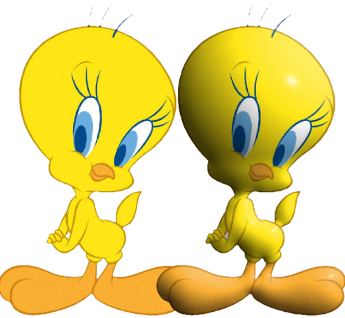

Pokejedservo Posted October 12, 2019 Share Posted October 12, 2019 Hey folks newbie Pokejedservo here I have a question that I just thought I ask. I have noticed that on Paint.Net I can use a character portrait png pic and use the rotate tool in layers so I can change Z-Axis on the portrait. Therefore turning it and make the portrait look like the character is facing to the right (or left) but since the portrait is 2D its flat. I did hear about this nifty little feature on Photoshop at... https://youtu.be/kqAi5mNa2gM I have tried stretching the portait after I turned its Z-Axis to the right but it has a tendency to make the character portrait appear rather blurry (and often enough not by a lot of stretching). And I also did try to use the "Bulge" feature in effects but I really wasn't sure how I would get that to work. Does Paint.net have any sort of feature like this (or at least by plugin) or no? If not then do you folks have any idea if there is any free Photo Editor program that does have that feature? Just thought I ask... Quote Link to comment Share on other sites More sharing options...
BoltBait Posted October 12, 2019 Share Posted October 12, 2019 1 hour ago, Pokejedservo said: Does Paint.net have anything like the "Inflate Tool" from Adobe Photoshop? No. Although, you could try the Effects > Selection (or Object) > Bevel Selection (or Object) plugin in my plugin pack. Quote Click to play: Download: BoltBait's Plugin Pack | CodeLab | and how about a Computer Dominos Game Link to comment Share on other sites More sharing options...
dipstick Posted October 12, 2019 Share Posted October 12, 2019 Though not quite as advanced, you could try "Illuminate 2D" filter in G'mic plugin. 2 1 Quote Link to comment Share on other sites More sharing options...

Pokejedservo Posted October 17, 2019 Author Share Posted October 17, 2019 Well I did try Bevel in that plugin pack but it didn't really work with me all that well for me. Say where is the plugin pack that has "Illuminate 2D" in it? I guess I should be a little bit more specific is that I have made character 2D models from this site in the past... http://pochi.eek.jp/m_kisekae.html (Note: The site is mostly in Japanese but this is the SFW version just to be safe so don't worry.) Anyways I have been using this site for some time which has plenty of options for customization and poses and such. But the only issue is that you can't have characters turn left or right. (Sure the eyes can change direction but the torso is forward position only.) I can take pictures of these models and have clear background png pics in which I can turn the characters left-right on the Z-Axis in the "Rotate Layer" option. But since these character model pics are 2D so therefore flat I'm trying to figure out a way how to stretch them with out them becoming overly blurry. So in other words to make a long story short I'm trying to take 2D characters and turn them to the side without making them flat or blurry. Note: On a different note is it possible to say for example I work on a picture collage and make it so that the layers can't be outside the canvas or overlap with one another? Just thought I ask if its remotely possible on paint.net. Quote Link to comment Share on other sites More sharing options...
Pixey Posted October 17, 2019 Share Posted October 17, 2019 @Pokejedservo you can find the Plugin that incorporates "Illuminate 2D" here: You can turn things sideways with the Plugin called Shape3D: There is a tutorial for making a collage: Or, you can just bring each image into a new layer and re-size as necessary Quote How I made Jennifer & Halle in Paint.net My Gallery | My Deviant Art "Rescuing one animal may not change the world, but for that animal their world is changed forever!" anon. Link to comment Share on other sites More sharing options...

Elvis Hbpbgrtnk Posted October 20, 2019 Share Posted October 20, 2019 (edited) OK. What is best settings for making 3D like that with Illuminate and Bevel?!?!? Edited October 20, 2019 by Elvis Hbpbgrtnk Fixing mistake Quote Link to comment Share on other sites More sharing options...
Pokejedservo Posted October 20, 2019 Author Share Posted October 20, 2019 Well I have downloaded the G'Mic and Shape 3D plugins, fairly liking the latter so far but I'm still learning how to use it. (But to be fair it is easier for me to learn than actual 3D programs like Blender and the like which is why I'm looking for things like this.) But as for G'Mic I'm still trying to figure out where exactly is the "Illuminate" function? Oh yes and as for Collages I do fairly know how to make one (been making them for a few years in programs like Pixlr and NCH PhotoPad.) But all I'm asking is if there is a way to get the pictures/layers to stay in the canvas and/or make it so that images/layers can't overlap each-other. Is that possible? Quote Link to comment Share on other sites More sharing options...
Elvis Hbpbgrtnk Posted October 20, 2019 Share Posted October 20, 2019 (edited) It under Light and shadows Illuminate 2D Shape. Edited October 20, 2019 by Elvis Hbpbgrtnk Quote Link to comment Share on other sites More sharing options...

Pokejedservo Posted October 20, 2019 Author Share Posted October 20, 2019 11 hours ago, Elvis Hbpbgrtnk said: It under Light and shadows Illuminate 2D Shape. Light and Shadows? Uh I still don't see it... Quote Link to comment Share on other sites More sharing options...
Pixey Posted October 20, 2019 Share Posted October 20, 2019 11 hours ago, Elvis Hbpbgrtnk said: I thinking I found settings but when I upload here it darker than what I save. Why that? It's darker because you used the Plugin Illuminate, which does that Quote How I made Jennifer & Halle in Paint.net My Gallery | My Deviant Art "Rescuing one animal may not change the world, but for that animal their world is changed forever!" anon. Link to comment Share on other sites More sharing options...
Pixey Posted October 20, 2019 Share Posted October 20, 2019 6 minutes ago, Pokejedservo said: Light and Shadows? Uh I still don't see it... @Pokejedservo It's in the Q'mic Plugin which is under Advanced dropdown: ~clicky~ Quote How I made Jennifer & Halle in Paint.net My Gallery | My Deviant Art "Rescuing one animal may not change the world, but for that animal their world is changed forever!" anon. Link to comment Share on other sites More sharing options...

Pokejedservo Posted October 20, 2019 Author Share Posted October 20, 2019 1 hour ago, Pixey said: @Pokejedservo It's in the Q'mic Plugin which is under Advanced dropdown: ~clicky~ Apparently something went wrong when I got the G'Mic plugin because I don't see the Advanced Dropdown anywhere. Quote Link to comment Share on other sites More sharing options...
Pixey Posted October 20, 2019 Share Posted October 20, 2019 It's built into Paint.net. Click on the Effects and it will be the first thing on the drop down list. Quote How I made Jennifer & Halle in Paint.net My Gallery | My Deviant Art "Rescuing one animal may not change the world, but for that animal their world is changed forever!" anon. Link to comment Share on other sites More sharing options...
Pokejedservo Posted October 20, 2019 Author Share Posted October 20, 2019 1 hour ago, Pixey said: It's built into Paint.net. Click on the Effects and it will be the first thing on the drop down list. Then something did go wrong for its not on my Effects Drop Down list at all. Quote Link to comment Share on other sites More sharing options...
Pixey Posted October 20, 2019 Share Posted October 20, 2019 Which version of Paint.net are you using? And is it Classic or Store bought? Quote How I made Jennifer & Halle in Paint.net My Gallery | My Deviant Art "Rescuing one animal may not change the world, but for that animal their world is changed forever!" anon. Link to comment Share on other sites More sharing options...
lynxster4 Posted October 20, 2019 Share Posted October 20, 2019 @Pokejedservo, this is what Pixey means and where to find it: Quote My Art Gallery | My Shape Packs | ShapeMaker Mini Tut | Air Bubble Stained Glass Chrome Text with Reflections | Porcelain Text w/ Variegated Coloring | Realistic Knit PatternOpalescent Stained Glass | Frosted Snowman Cookie | Leather Texture | Plastic Text | Silk Embroidery Visit my Personal Website "Never, ever lose your sense of humor - you'll live longer" Link to comment Share on other sites More sharing options...
Pokejedservo Posted October 20, 2019 Author Share Posted October 20, 2019 54 minutes ago, Pixey said: Which version of Paint.net are you using? And is it Classic or Store bought? Classic and its version 4.2.5 so its the current version. Quote Link to comment Share on other sites More sharing options...
Pixey Posted October 20, 2019 Share Posted October 20, 2019 Please go to your Effects Folder and see if G'mic is there: Instructions: Spoiler 1. Close Paint.NET. 2. Place Gmic.dll and the gmic folder in the Paint.NET Effects folder which is usually located in one the following locations depending on the Paint.NET version you have installed. Classic: C:\Program Files\Paint.NET\Effects 3. Restart Paint.NET.4. The plug-in will now be available as the G'MIC-Qt menu item in the Advanced category of the Paint.NET Effects menu. Quote How I made Jennifer & Halle in Paint.net My Gallery | My Deviant Art "Rescuing one animal may not change the world, but for that animal their world is changed forever!" anon. Link to comment Share on other sites More sharing options...
