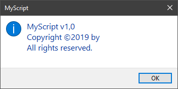

That's likely just a difference in the TaskDialog API, related to the change "Fixed: Simple message boxes can now be closed with the ESC key". *shrug* Not sure much can be done about it.
