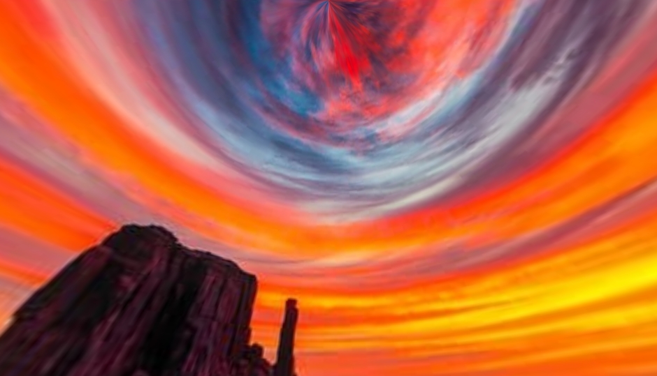

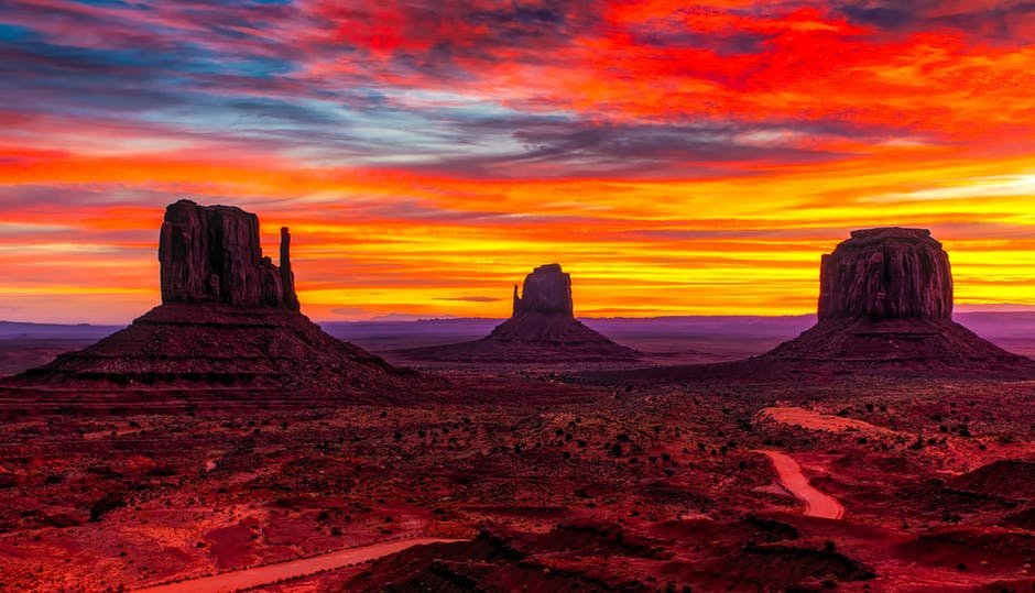

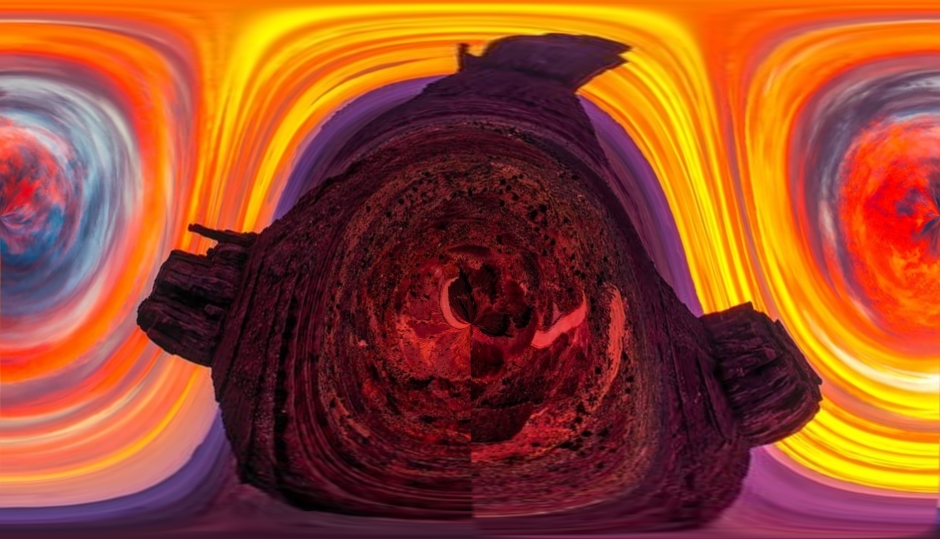

This is really cool @MJW  ?    Here are my examples:
Original
View Mode
Transform Mode
I can see this plugin being very useful, especially with the Texture Shader plugin!   Thank you so much!   :beer:
