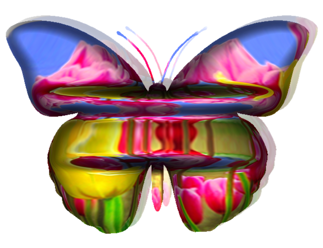

Great plugin @MJW!    :star:     Of course, I had to try it on a shape that wasn't recommended.  I see what you mean. Even though the butterfly is symmetrical, it doesn't handle it well around the body.

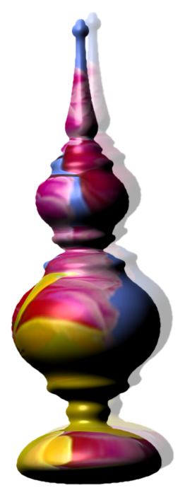

I tried next on a recommended shape and the result is fantastic!  I smoothed the height map and applied an image with Texture Shader.
There is so much potential here, I am speechless.....
Thank you!    <3
