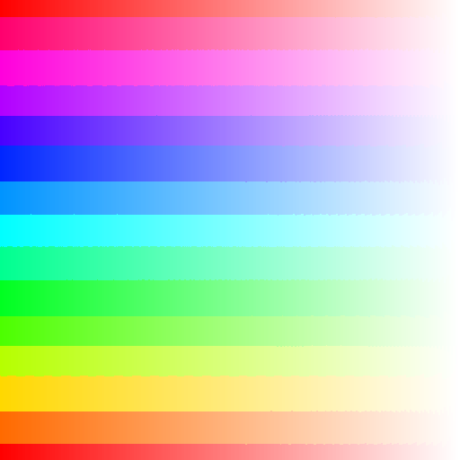

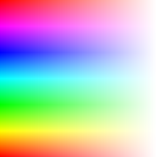

Here's a demonstration, using the default palette.
Original image:
With Ignore Opacity When Comparing Colors enabled:
Recolor-Using-Palette-Tests-Img-No-Opaci
With Ignore Opacity When Comparing Colors disabled:
Recolor-Using-Palette-Tests-Img-With-Opa
(To be useful in this mode, the palette would likely need to be better suited to the image than it is in this case.)
Ignore Opacity When Comparing Colors is disabled by default.
