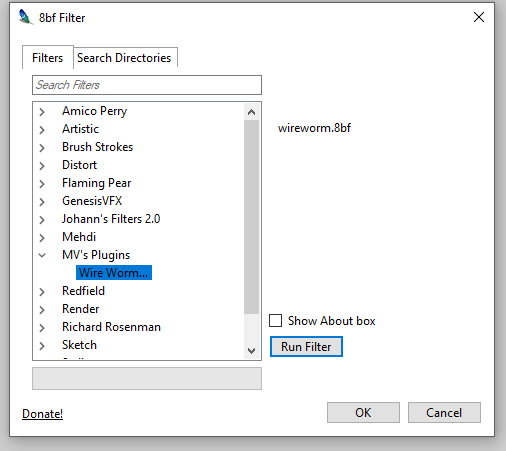

Pixey Posted April 19, 2021 Share Posted April 19, 2021 @scryer52 have you downloaded the filter that is required for using this filter, which is found here: PSFilterPdn (2019-01-04) - Plugins - Publishing ONLY! - paint.net Forum (getpaint.net) Then download the Wire Worm : Wire Worm - Free download and software reviews - CNET Download 1. Unzip the file you downloaded. 2. Put the wirewom64bit.8bf into your Paint.net Effects Folder. Then restart PDN. 3. Look in the drop-down under Effects and you will see a feather which says 8bf filter. Click on that and a Menu will show up. You can watch a video: Quote How I made Jennifer & Halle in Paint.net My Gallery | My Deviant Art "Rescuing one animal may not change the world, but for that animal their world is changed forever!" anon. Link to comment Share on other sites More sharing options...
scryer52 Posted April 19, 2021 Share Posted April 19, 2021 I have. I also down loaded the 8bf file. None of them are showing. Quote Link to comment Share on other sites More sharing options...
Pixey Posted April 19, 2021 Share Posted April 19, 2021 @scryer52 which version of Paint.net are you using? Is it the store bought, or the Classic version? If classic, look in your Effects to see if you put the 8bf into it: Quote How I made Jennifer & Halle in Paint.net My Gallery | My Deviant Art "Rescuing one animal may not change the world, but for that animal their world is changed forever!" anon. Link to comment Share on other sites More sharing options...
scryer52 Posted April 19, 2021 Share Posted April 19, 2021 15 minutes ago, Pixey said: @scryer52 which version of Paint.net are you using? Is it the store bought, or the Classic version? If classic, look in your Effects to see if you put the 8bf into it: I have. I also down loaded the 8bf file. None of them are showing. Quote Link to comment Share on other sites More sharing options...
scryer52 Posted April 19, 2021 Share Posted April 19, 2021 That did the trick. Thanks for the help! 1 Quote Link to comment Share on other sites More sharing options...
null54 Posted April 19, 2021 Share Posted April 19, 2021 1 hour ago, Pixey said: If classic, look in your Effects to see if you put the 8bf into it: Placing 8bf files in the Effects folder should work for both the classic and Store versions of Paint.NET. 1 Quote Plugin Pack | PSFilterPdn | Content Aware Fill | G'MIC | Paint Shop Pro Filetype | RAW Filetype | WebP Filetype The small increase in performance you get coding in C++ over C# is hardly enough to offset the headache of coding in the C++ language. ~BoltBait Link to comment Share on other sites More sharing options...

scryer52 Posted October 25, 2021 Share Posted October 25, 2021 On 10/22/2021 at 11:32 AM, Pixey said: Hello @scryer52 here you go: The 8bf Filter is missing. I've downloaded this, but it still needs the 8bf. I forget where to find that. Quote Link to comment Share on other sites More sharing options...
null54 Posted October 25, 2021 Share Posted October 25, 2021 5 minutes ago, scryer52 said: The 8bf Filter is missing. I've downloaded this, but it still needs the 8bf. I forget where to find that. The site that hosts the 8bf file was linked to earlier in this thread. On 7/30/2016 at 3:10 PM, Pixey said: How to get the Wire Worm http://www.vicanek.de/imageprocessing/wireworm.htm Quote Plugin Pack | PSFilterPdn | Content Aware Fill | G'MIC | Paint Shop Pro Filetype | RAW Filetype | WebP Filetype The small increase in performance you get coding in C++ over C# is hardly enough to offset the headache of coding in the C++ language. ~BoltBait Link to comment Share on other sites More sharing options...
