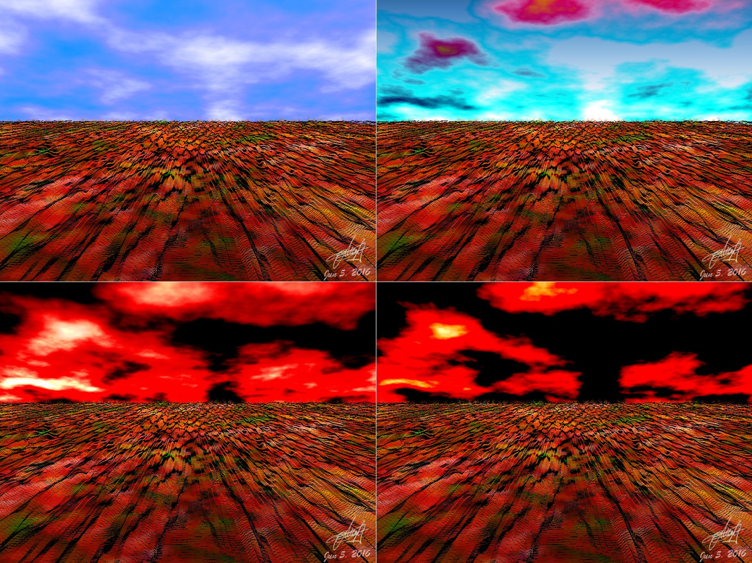

Maximilian Posted June 6, 2016 Share Posted June 6, 2016 (edited) This may be a rather far-fetched application, but I've found that this plugin produces nifty tweaks on skies, particularly if I want to turn a sky into a bloody sky or maybe if I just want to turn a few clouds into bloody clouds. Follows an example of what I mean (source image in the top left corner of this collage is a 100% PdN landscape, plus three results obtained after applying the effect on the sky layer and playing a little with blend modes). Click on thumbnail for a full-size picture: Very many thanks, MJW! You're definitely an A+ coder! Here's the plugin for users of Paint.NET 3.5.11 HotMetalGlow 1.2 for PdN 3.5.11.zip Edited September 30, 2018 by Maximilian fixed broken link 4 Quote Link to comment Share on other sites More sharing options...
