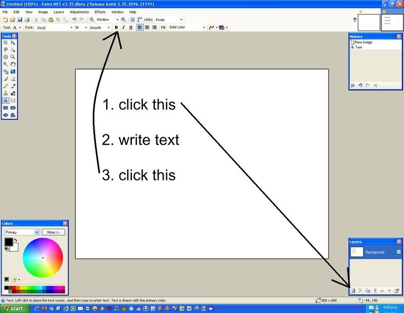

lonesky1 Posted June 29, 2008 Share Posted June 29, 2008 Hello, I'm a total newcomer to paint.net; I've got the latest version. I'm exploring this because I couldn't do something rather simple in Microsoft Paint. I have printed out the entire "Help" section & read it, but cannot find this simple topic. I've also done a search a few times & came up with nothing. OK, the very simple thing I'm trying to do is this: After you've typed out some text, how do you selectively bolden or underline parts that you want? For a start, I tried highlighting the words that I wanted to impart these attributes, but I couldn't do it! (It appears you cannot highlight parts of a text. Is that right?). When I tried to bolden or highlight certain words or parts of a text, the entire text would be bolden or underlined! Same problem a I encountered in Microsoft Paint. Is this how it is meant to be? OR is there a way around it? I would really like to resolve this ASAP. Thanxx very much in advance for any help/advice. Quote Link to comment Share on other sites More sharing options...
