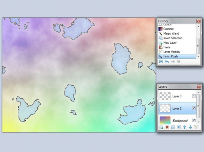

Start off with cloud plugin with white and secondary color set to transparent. Bottom layer is so you can see.
I did a gradient color so you can see it is transparent. Wand it to try and capture the whitest areas to use as highlights, and hit control I to invert selection. Copy and paste that to a new layer.

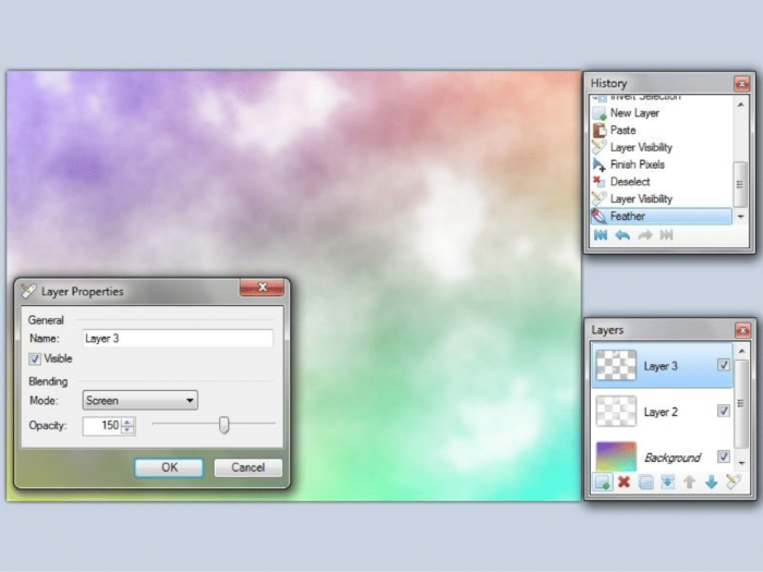

Feather the edges of the top layer to soften them. And adjust layer properties to your liking.
